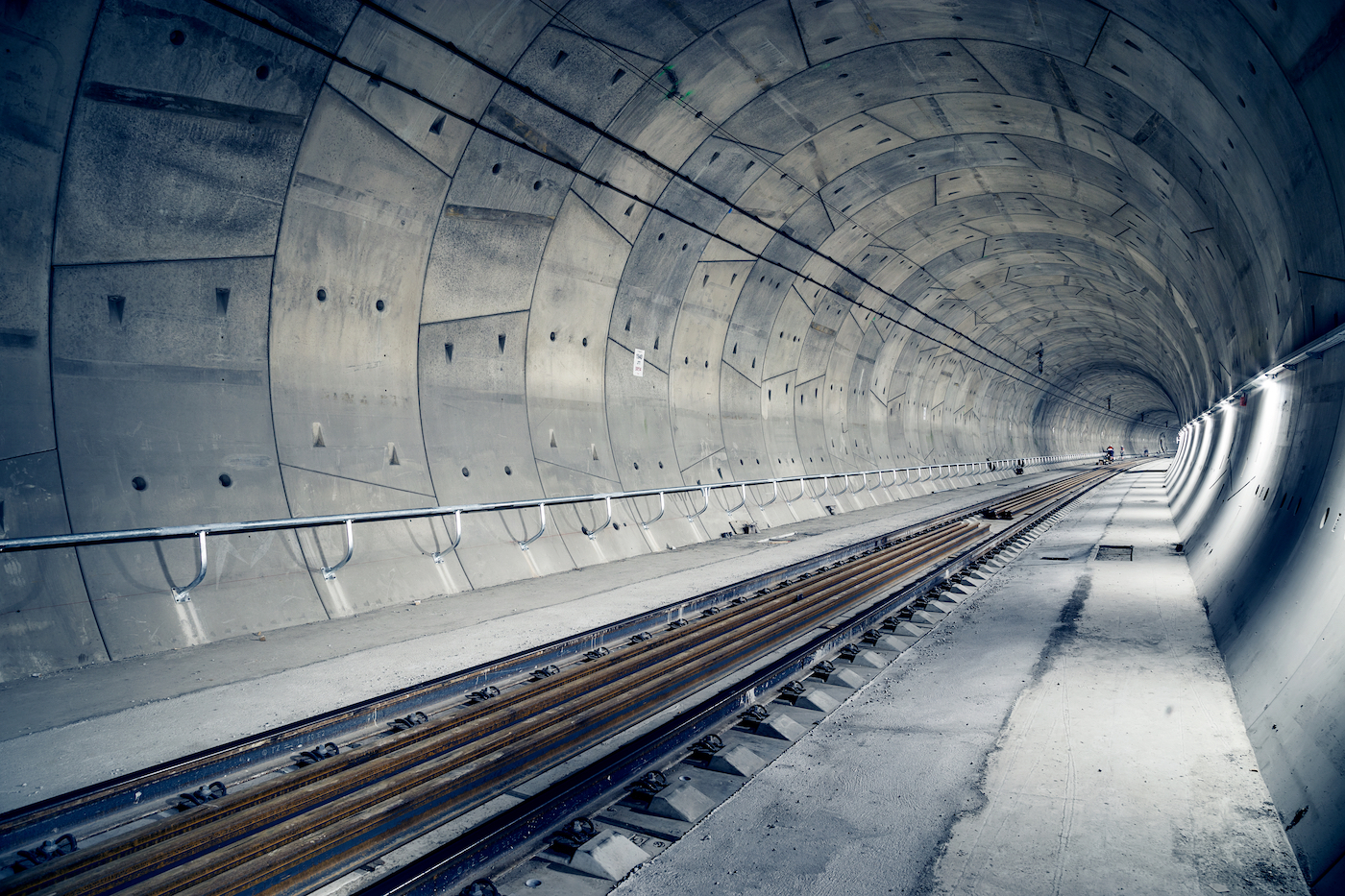

Challenge — Aging Infrastructure and New Lines
Like other transit systems of the same vintage, TTC had an aging infrastructure in place. Previous galvanized electrical conduits created a safety concern in the event of an emergency situation like a fire, where the metals would create a brass alloy and render cables useless.
Additionally, the TTC was expanding. They were opening new stations, so the organization wanted to take advantage of the latest innovations for safety.
A Safe Solution for Tunnels
TTC project stakeholders researched the safest options in fire-proof electrical conduit. They discovered Champion Fiberglass® Flame Shield phenolic electrical conduit provided a superior level of safety required for the transit system. That is, in a transit fire situation, Champion Fiberglass phenolic conduit provides a two-hour fire rating when used in conjunction with fire-rated life safety circuit (fire sprinkler, ventilation & lighting) cables.
Further, the conduit meets the following safety standards and listings: NFPA 130 and NFPA 502, ASTM E136, and UL 2515-A Listed for Phenolic XW Conduit. Most recently, Champion Fiberglass has achieved UL 2196 FHIT 28E for RHH Dry Applications designation with our partner Radix Wire & Cable.
In addition to the safety benefits, fiberglass phenolic conduit comes in at less weight than steel. Plus, labor takes less time per the NECA Manual of Labor Units.
As for installation, the TTC tunnels performed a jack and bore installation technique utilizing Champion Fiberglass epoxy conduit. The mechanical strength of Champion Fiberglass epoxy conduit allows it to be utilized for this type of specialized complex installation.
Another advantage that Champion Fiberglass conduit has over steel electrical conduit is that it provides some installation flexibility. Heavy steel conduit is very rigid. Champion Fiberglass phenolic and epoxy conduits offer enough flexibility to adapt to minor tunnel elevational and directional changes while still providing mechanical protection.
Results — Performance Electrical Conduit
For the TTC, Champion Flame ShieldⓇ phenolic conduit offered a safe electrical conduit solution in established and new tunnels for Toronto area commuters. With zero smoke characteristics and a 2-hour temperature rating, Champion Fiberglass phenolic conduit helps insulate cables for reliable fire protection in tunnels. Finally, the conduit’s light weight yet strength aided a jack and bore installation.
