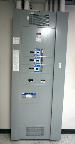

The scenario
The switchboard in Photo 1 must be verified to be in an electrically safe work condition before a breaker can be replaced. The term “electrically safe work condition” more accurately describes the task to be accomplished rather than just “de-energized.” In this scenario, the switchboard is fed from a 480V insulated case circuit breaker located elsewhere in the plant. Opening this breaker does not guarantee all power is de-energized. Through the completion of five practical steps, the switchboard can be verified to have all sources of power removed, ensure it is safe to perform the work, and identify the personal protective equipment (PPE) and safe work practices necessary to protect the worker in the unlikely event something should go wrong.

The following eight steps are used to create and verify an electrically safe work condition for the switchboard (Photo 3):
  1. All possible sources of electrical supply to the switchboard were determined using electrical drawings and identifying equipment using the equipment labels.
  2. The loads fed by the switchboard were first shut down, and the insulated case feeder breaker supplying the switchboard was opened.
  3. Mechanical indication on the feeder breaker was used to verify the breaker is “open.” When possible, visually verify all blades are open on disconnect switches. Drawout-type circuit breakers are withdrawn to the test or fully disconnected position.
  4. The system was examined to ensure capacitors were not present in the switchboard circuit supply or loads. Capacitors store electrical energy and must be properly discharged.
  5. Devices that store nonelectrical energy were not found in the system. ATSs or other devices that could re-energize the switchboard were not in the electrical system.
  6. The lockout/tagout device was applied to the feeder breaker per the facility’s procedure.
  7. Once the cover to the buswork was removed, a multimeter was used to verify the absence of voltage in the switchboard. Both phase-to-phase and phase-to-ground measurements were taken and read 0V. However, that does not guarantee the meter was working properly. A three-point test method or “Live-Dead-Live” test is used to verify the absence of voltage. The meter was first verified to be working properly on AC voltage by testing it with the meter proving unit hanging adjacent to the meter. Refer back to Fig. 2. After the 0V reading was obtained (phase-to-phase and phase-to-ground), the multimeter was once again verified to be operating properly using the meter proving unit.
  8. The final step would be to install temporary personal protective grounds if needed. However, it was determined there was no possibility of induced voltages, stored electrical energy, or other potential dangers. Temporary grounds were not required.
Completion of these eight steps has placed the switchboard into an electrically safe condition. Since the equipment is now verified to be in an electrically safe work condition, electrical PPE (insulated rubber gloves, face shield, arc-rated clothing, etc.) can be removed, and work on the equipment can begin.
