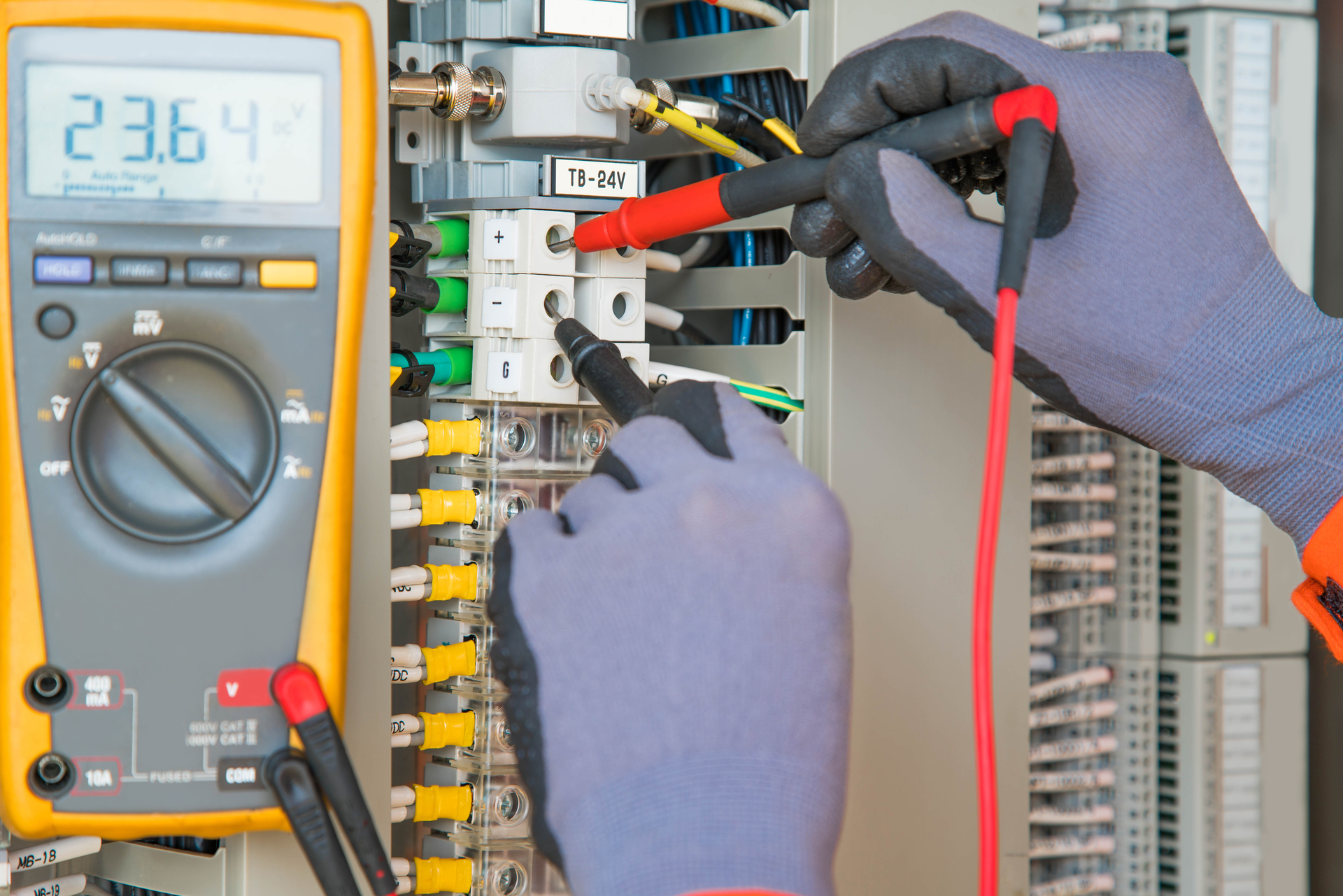

The eighth example, “Using the right tools for the job,” is a major principle that should be felt in your procedures and ongoing training, in addition to the electrical safety program. This would include such things as using a digital multimeter (DMM) rated for the energy level, using insulated hand tools as opposed to uninsulated ones, and using a tool suitable to the voltage or current environment (e.g., don’t use a DMM inline to measure current on a 200A circuit).
