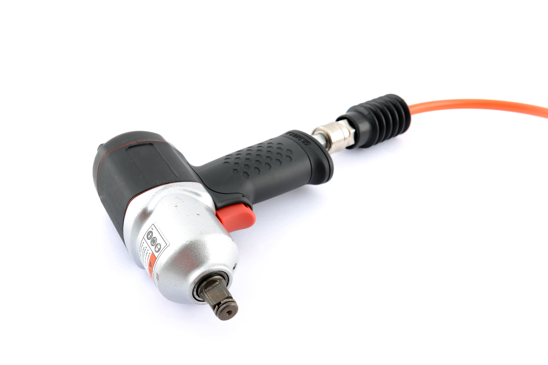

Pneumatic tools are commonly used on construction sites, usually with portable compressors. And it’s the rare manufacturing plant that doesn’t have a plant air system, and along with it a variety of equipment that runs on compressed air. That equipment includes not just pneumatic hand tools but also actuation cylinders, pneumatic motors, and other equipment upon which production relies.

Some other safety practices:
- Wear safety glasses (with side shields) or safety goggles any time pneumatic tools are being used near you. It doesn’t matter if you are not personally using them; the compressed air won’t know that.
- Treat compressed air hoses like test leads; inspect them carefully for damage before you use them. Don’t try to repair the damage with tape. Either replace the entire hose or use an approved repair method such as cutting out the damaged part and joining the ends with approved fittings.
- Ensure fittings are tight; this includes quick connectors.
- Never pinch or kink (fold over) an air hose to regulate or stop the airflow. This can result in a hose rupture with horrible consequences.
Pneumatic tools have a long history of being widely used in manufacturing. They also are used on construction sites. They are sometimes the tool of choice over a battery-powered or line-powered tool, especially in hazardous locations. Just as compressed air isn’t “free” (it costs more per unit of work done than electricity does), it’s not inherently safe either.
