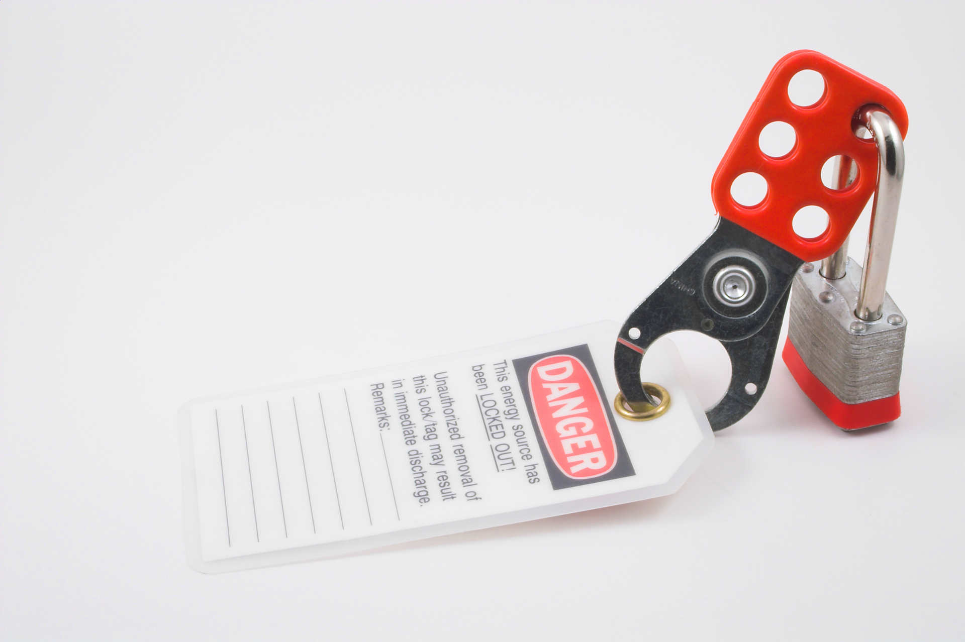

You have a job to do, and your employer has a lockout/tagout (LOTO) plan that is compliant with both OSHA 1926.417 and NFPA 70E, Art. 120. The problem is those standards don’t seem to have anticipated a particular obstacle you now face. You have some options, but what decision do you make? Let’s consider three obstacles that have cropped up at various facilities.
Obstacle 1: Full hasp
You want to hang your lock on a breaker, but it already has a hasp on it, and every hole on the hasp has someone else’s lock. Among those is a “master lock” assigned to the operations shift supervisor. The master lock means whoever is the shift supervisor can remove the lock; a record is kept in a book on the shift supervisor station.

Try one of these two solutions:
  1. Inform your supervisor of the situation and move on to a different job. Come back to this one later.
  2. Advise everyone with a lock of the situation, and ask them all to meet you at a predetermined time to remove all locks, hang a longer hasp, and replace all locks.
