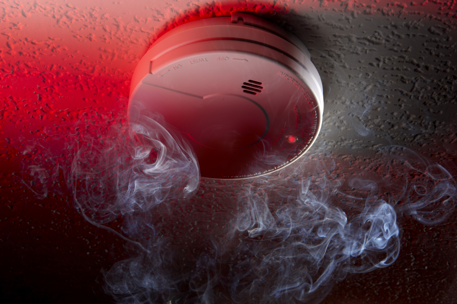

During residential inspections, my biggest challenge is getting electricians and contractors to accept that the “old” way of installing smoke alarms and carbon monoxide (CO) detectors is no longer adequate. This is definitely what I consider a cross-code (or cross-over code) issue. Not only do electricians and builders not know the proper installation requirements for these safety devices, but most inspectors also don’t know as well. I find this troubling as the reference to the primary code for smoke alarms and CO detectors (NFPA 72, National Fire Alarm and Signaling Code) has been referenced in the International Residential Code (IRC) since it was first published in 2000.
Most electricians are familiar with the basic location requirements for these devices. For example, place a smoke alarm in each sleeping room, in areas outside bedrooms, and on each floor of the dwelling, including basements and cellars. They also know smoke alarms shall receive their primary power from the building wiring (with battery back-up) and shall be interconnected in such a manner that the actuation of one alarm will activate all the alarms. But many electricians would struggle to cite additional requirements beyond this basic list.
Let’s take a closer look at the smoke alarm and CO detector requirements outlined in the most current editions of the IRC and NFPA 72.
