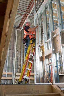

Maybe you’ve gone up that ladder 100 times. The 101st time is no time to get lax when it comes to personal safety. Always pay attention to what you are doing when climbing and using your ladder. Some tips are just common sense. Face the ladder and have a firm grip. Don’t have hands distracted with other materials. Keep hands free by using a tool belt or some other means, such as a material lift, tag line, or rope, to raise equipment to the work area. Remember to maintain three points of contact as you climb: two hands and one foot or two feet and one hand on the ladder. And don’t do unnecessary reaching. A good rule of thumb: keep your belt buckle between the rails.
Safety at the top
You’re finally at the uppermost point of your ladder. This is no time for slacking off. Contact with the ladder is important not only while climbing, but also while working. To that end, the top step and the top cap of a stepladder and the top three rungs of a single or extension ladder are not suitable standing surfaces. The few upper feet of the ladder are there for body support, so you don’t have to balance on just your two feet. If you are transitioning from the ladder onto another surface, your ladder must be secured from movement.
