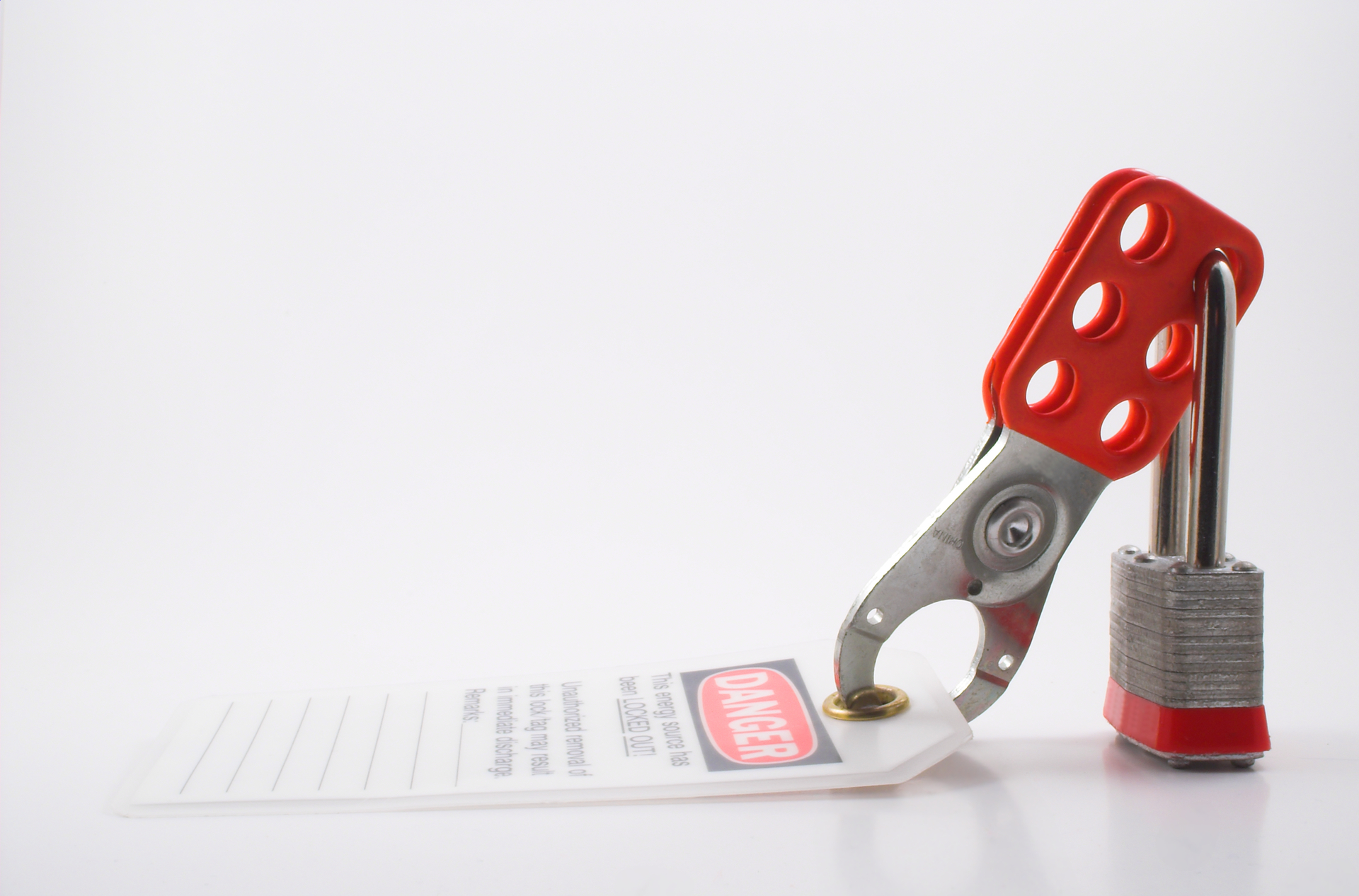

Responsibility No. 1: Providing the equipment necessary to execute lockout/tagout procedures.
This doesn’t mean providing a communal box of locks. It starts with assessing what each individual employee will need for individual locks.
Save employee time and eliminate legibility issues by having preprinted tags specific to each employee. The tag should have the employee’s name and department at a minimum. Adding the employee’s photo to his or her tags will increase the cost, but many plant managers and service firm operations managers consider this a good investment. Such tags also improve plant security, because they are individually issued rather than ad hoc created from a box of blanks by just anybody. Another reason for having individual, pre-printed, photo-included tags is an employee’s locks and tags must be removed at the end of the shift and resolving problems is much easier this way.
Additionally, the employer needs to provide sufficient gang hasps to permit hanging multiple locks on one energy control device. A common example is Jennifer and John, the two electricians on the job, who each hang a lock. A lock for the production superintendent (which may be issued to the position, not the individual) may also be hung there. An individual operator may also have a lock.
The fact that hanging locks is a requirement also means the employer must provide a lockable means of isolating energy. Some people interpret this to mean “where possible” under the assumption if a circuit breaker doesn’t have this provision then it’s not possible. Adding a disconnect switch between the breaker and the equipment makes this possible. Don’t look for reasons to get away with non-compliance; look for ways to comply.
