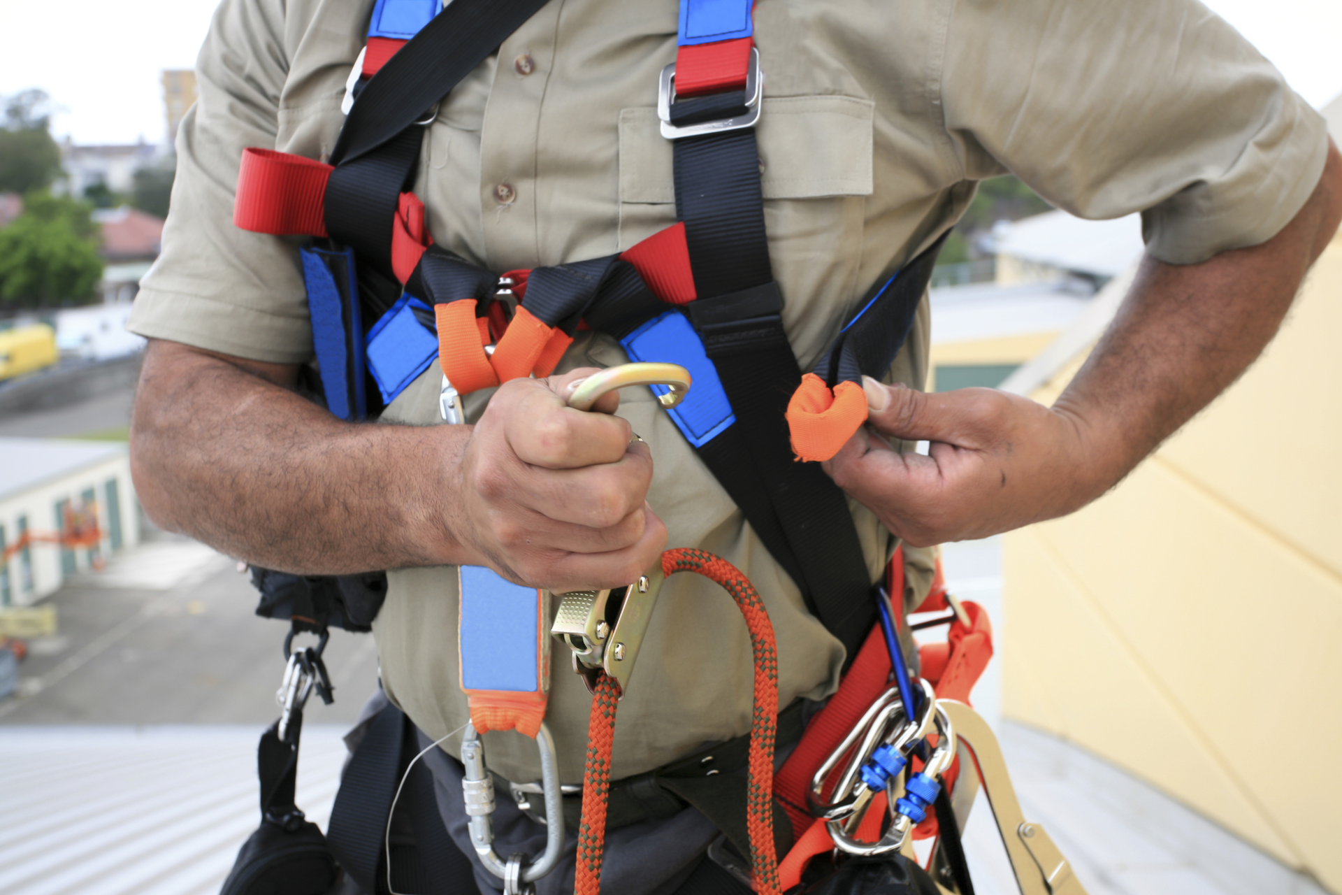

Standard 1926.501(b)(11) applies to steep roofs. But unlike the low-slope roof requirements, there’s no mention here of doing roofing work. While it’s unlikely you would be installing HVAC systems on a steep roof, you could very well be installing lightning protection, lights, security cameras, or de-icing system components. If the sides or edges are unprotected — and either is 6 ft or more above lower levels — each employee must be protected from falling. The three acceptable methods are guardrail systems with toeboards, safety net systems, and personal fall arrest systems.
