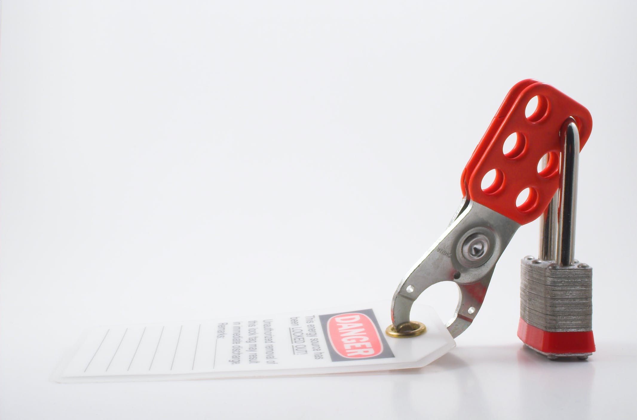

What about making electrical LOTO devices similar to other LOTO devices? And how can you ensure LOTO devices are used for no other purpose? Many sites adopt a color scheme or some other method to identify LOTO locks, and those locks are issued to individuals. LOTO training must include the concept of not using LOTO locks for anything else and not using any other kind of lock for LOTO.
