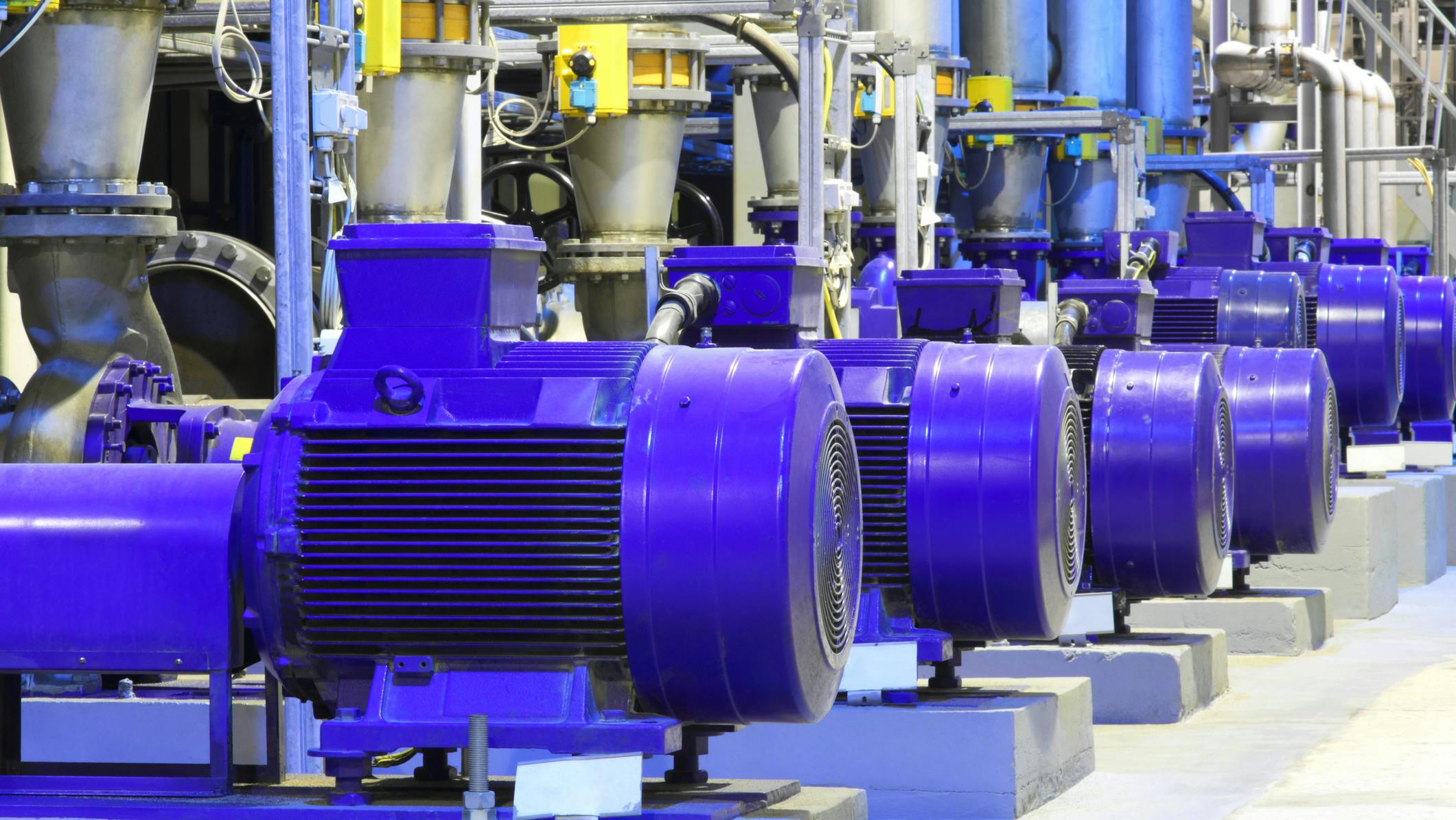

Motors beyond a certain size are too heavy and bulky for a person to lift. In the typical industrial setting, there are many such motors. And because of their weight and bulk, they pose hazards beyond just the electrical ones — crushed fingers and strained backs, for example.
The most effective way to eliminate the electrical and physical hazards presented by replacing these motors is to prevent the need to replace them. To do that, address common causes of motor failure such as:
