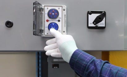

Absence of voltage tester
An absence of voltage tester (AVT) is designed to confirm the absence of electrical voltage without the need to physically open equipment doors, thus minimizing the risk of exposure to electrical hazards. Its significance has been acknowledged by NFPA 70E 2021, which updated Rule 7 of Section 120.5, replacing the term “permanently mounted test device” with “permanently mounted absence of voltage tester” for clearer safety guidelines. Additionally, it mandated that AVTs adhere to the standards set by UL 1436.
The evolution continues with the NFPA 70E 2024 update in Rule 7 of Section 120.6, emphasizing the necessity of testing “at each point of work.” This highlights the crucial aspect of conducting voltage tests directly where tasks are being carried out, further enhancing workplace safety standards.
Understanding how an AVT works
An individual simply presses a button to initiate a test sequence that fulfills all the requirements for verifying the absence of voltage. The AVT ensures its satisfactory function via a supervisory circuit that conducts continuity checks to confirm secure and correct connections. Only after these steps are satisfied will the AVT check for the absence of both AC and DC voltage, including phase-to-ground and phase-to-phase. If everything passes, the system repeats the steps a second time. If the second test is successful — and there is less than 3V AC or DC in the circuit — a green light(s) indicator shows the situation is safe, and the electrical panel door can be opened.
In the case of an unsuccessful test, amber light(s) stay illuminated, indicating a potentially unsafe condition. The next step is to retest the installation and wait for an additional 10 sec. If the test is unsuccessful a second time, the only option is to put on personal protective equipment (PPE), open the door, and troubleshoot the situation. This push-to-test feature of AVTs enhances efficiency in a facility, eliminating the need for manual testing and minimizing exposure to electrical dangers.
The AVT’s entire test sequence is visually represented in Fig. 5.
To guarantee safety and effectiveness, Section 12 of UL 1436 outlines the operational standards for AVTs. These guidelines include specific testing procedures and requirements, mandating compliance with Functional Safety IEC 61508 and SIL 3 certification. SIL 3 certification underscores the fail-safe nature of the product, signifying that the occurrence of a hazardous condition must happen less than once in 10,000,000 hours of operation, on average. This rigorous criterion implies a potential failure rate of less than one instance in more than 1,000 years.
AVT benefits
AVTs reduce the likelihood of human error in verifying the absence of voltage. Unlike traditional methods that may involve physical contact with live parts, AVTs offer a non-contact solution, minimizing the risk of accidents.
The display unit of an AVT is mounted on the door and connected to the control module through a communication cable, ensuring that no hazardous voltage reaches the door. The tester is installed on the load side of a disconnect switch, with no connections to the line side. When operational, the device has no more than 3V.
