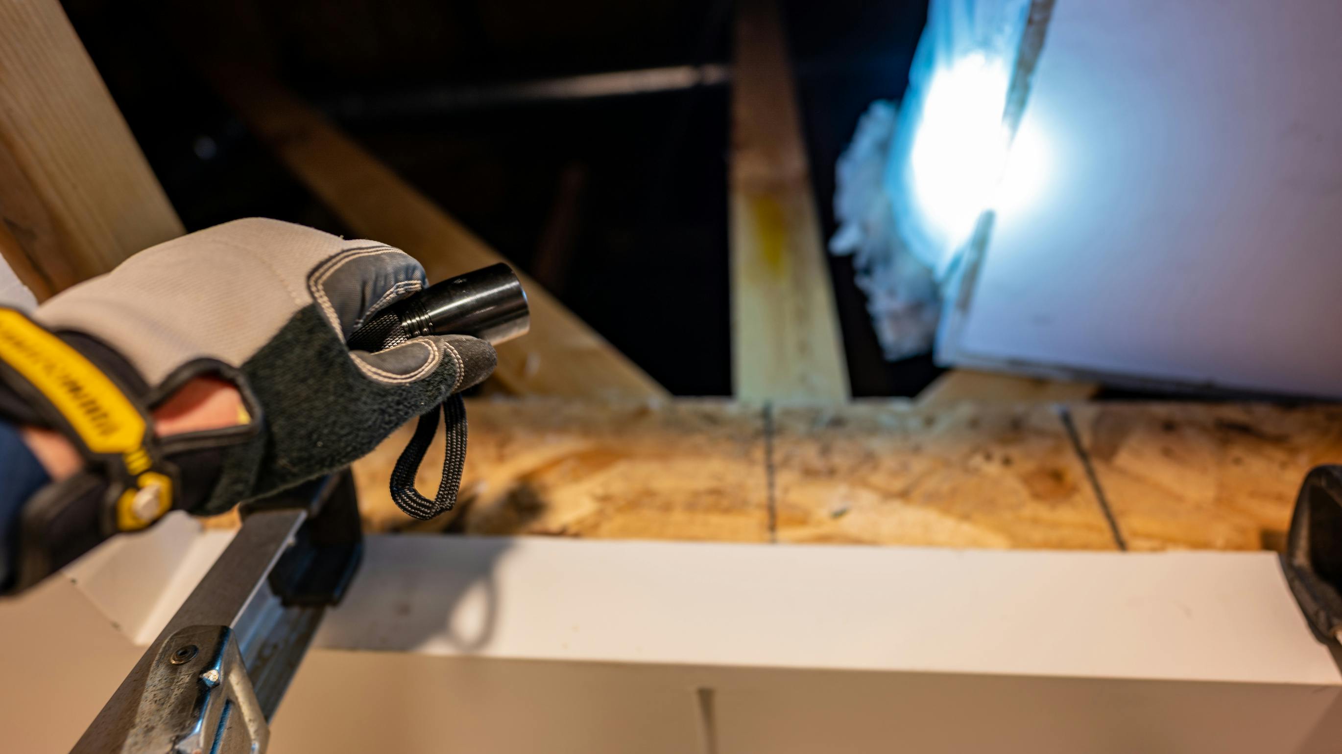

Ceiling spaces tend to be not far from grade level, and thus seem safer than they actually are. This factor contributes to many of the injuries that occur among those who work in such spaces. Follow these tips to work safely in ceiling spaces:
  1. Scope it out. Identify what’s up there, what system voltages are involved, and where junction boxes are. This is especially important if you are pulling wire (or cable) or running raceway.
