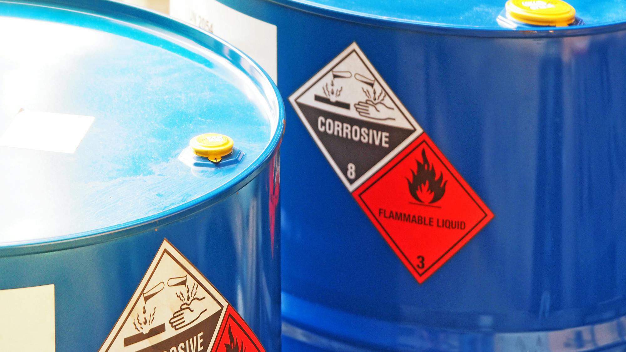

3. Labeling
  • Label all containers of hazardous chemicals with the appropriate hazard warnings. Labels must include the product identifier, signal words (e.g., Danger, Warning), hazard statements, precautionary statements, and the manufacturer's name and contact information. 
  • Ensure labels are legible and maintained in good condition. 
