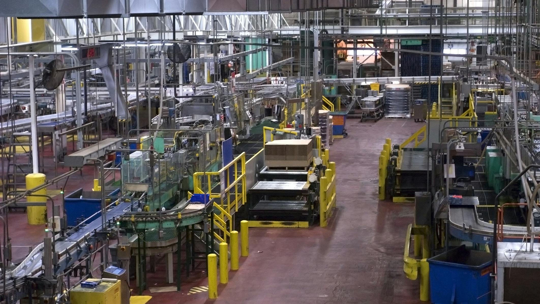

A consulting engineer, contract electrician, thermographer, or other outside expert entering a client facility needs to quickly assess the general safety level and the condition of specific equipment. If you are part of the facility staff and you work in maintenance, heeding these danger signs (and resolving the identified problems) is crucial because you are exposed every day.
Among many things to look for, these are arguably the top six:

There are many other signs to spot — for example, food wrappers on the production floor, enclosure doors hanging open, floor fans blowing on switchgear, lift truck dents in transformer cases, or stuff piled in the walkway leading to an emergency exit door are additional signs that safety may not be top notch on this site. The more of these signs you see in a single facility, the more dangerous it is to be in there. Sometimes, a decision to not be there is called for.
