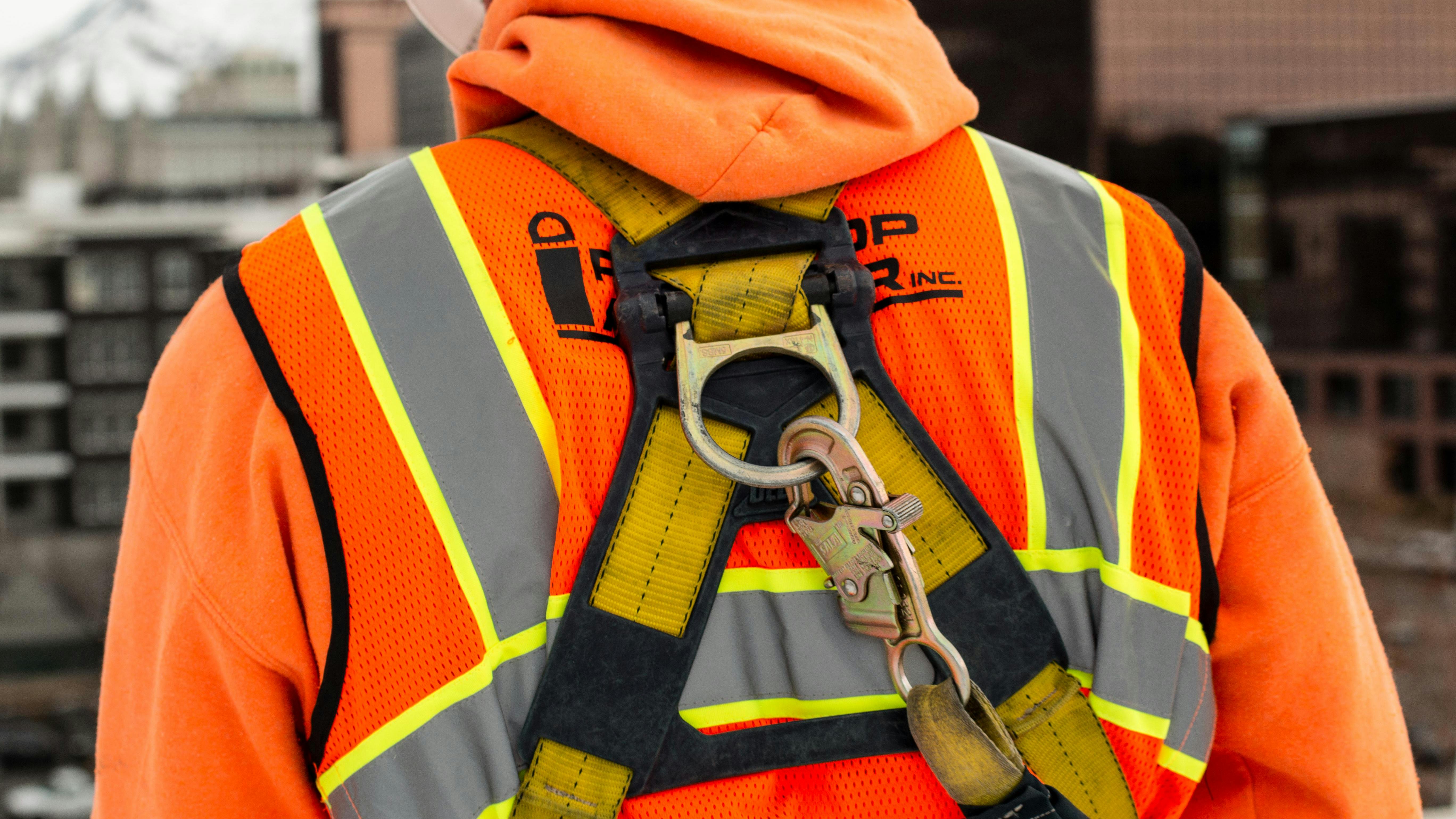

Fall arrest systems are extremely common on job sites, but it is important to remember that the worker will be 100% exposed to the fall hazard while working in a personal fall arrest system (PFAS). While fall arrest equipment is intended to prevent the user from falling all the way to the next lower level, it does not guarantee injury or fatality prevention. In fact, the Center for Construction Research & Training (CPWR) reported that nearly 60% of fall fatalities occurred while the user was wearing fall protection equipment, according to a study conducted in 2021. Equipment misuse can create unforeseen vulnerabilities in fall protection systems, leading to avoidable injuries or fatalities.
Training employees for provided solutions
Fall arrest systems will require the most training because many factors can affect their effectiveness when a fall occurs. Body harnesses are not “one size fits all,” so users must know how to properly adjust their harness to their body. If a harness is too loose, the user can be ejected from the harness during a fall arrest. And if a harness is fit too tightly, it can further restrict blood flow while the user is suspended and awaiting rescue.
Minimum fall clearance requirements must be adhered to when assigning connection devices to users. That is the minimum required distance between the user and the next lower level, and the product’s instruction manual will include this information. For example, 6-ft shock-absorbing lanyards typically require at least 18 ft of fall clearance to guarantee fall arrest can occur. Users working below that height may be at risk of contacting the ground before their fall is fully arrested. If a body in motion contacts the ground before fall arrest is complete, the user will sustain more severe injuries.
Self-retracting lifelines (SRLs) will require less fall clearance, but employers must confirm their workers are always working above the minimum clearance as specified by the manufacturer. Additionally, employers must confirm that minimum fall clearance requirements can be met before assigning certain connection devices to their workers.
