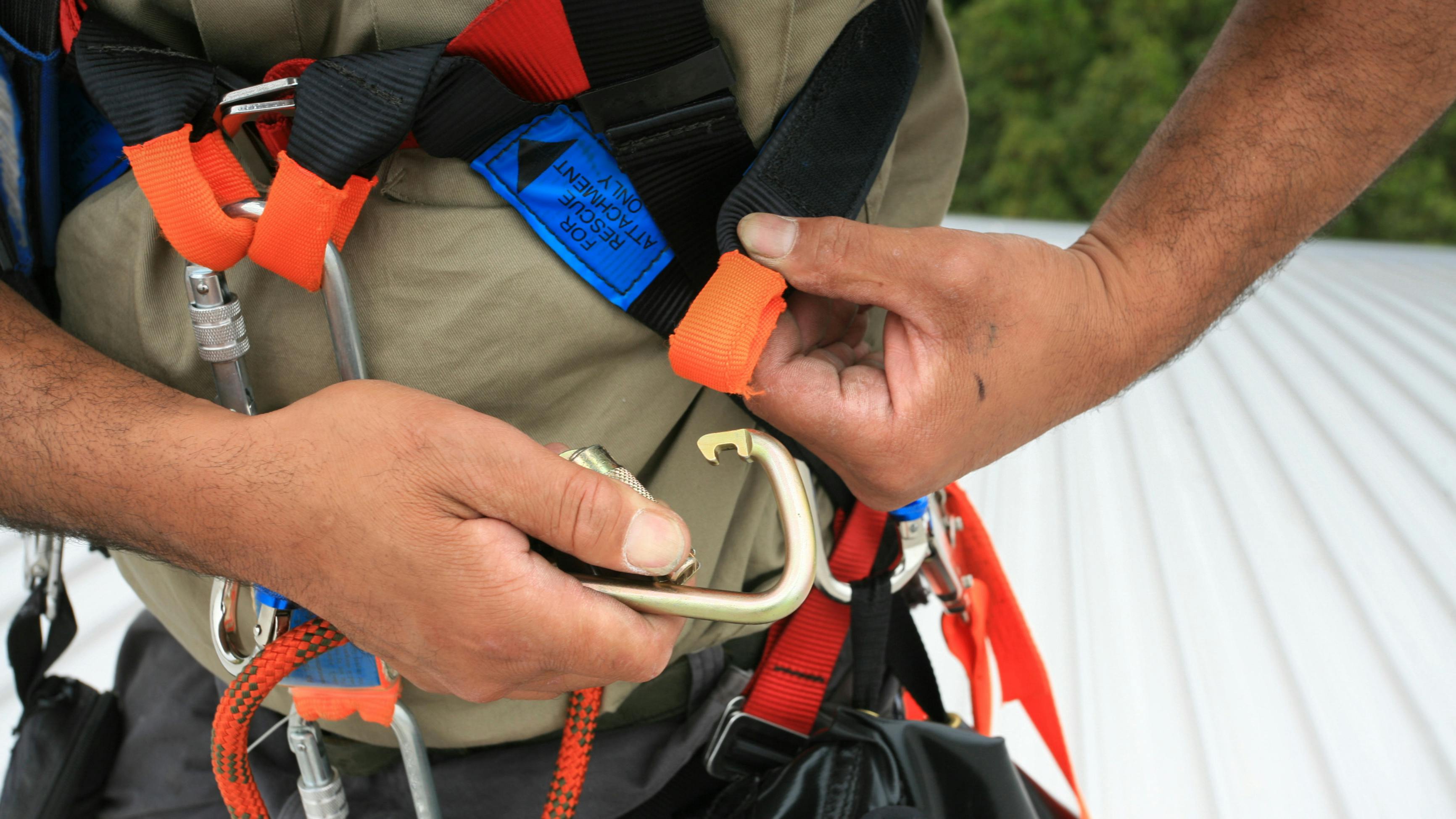

Correctly use the appropriate PPE
A harness and lanyard won’t protect you on the way up; that job falls mainly to your shoes. One of the safety features of a work shoe (or boot) is the superior traction it provides compared to, say, a casual leather shoe. When you’re climbing a ladder, there is a far greater chance you will slip with your foot than with your hand. You reduce that chance dramatically with a pair of serviceable OSHA-compliant (e.g., ASTM F2412) work shoes.
Employer-provided personal protective equipment (PPE) ranges from nets to harnesses. Whatever it happens to be, assume it isn’t suitable until you establish otherwise. Is the net suspended with enough room under it that you won’t get impaled? Is your harness past its “freshness date”? Do not use expired PPE. Visually inspect all PPE and reject ones that show any signs of damage or wear.
Fall protection PPE for construction and maintenance is designed for a quick catch, not a soft catch. For example, there is hardly any give in a fall protection lanyard. When it catches, the user feels the full force. To limit the energy involved, lanyards are limited to 6 ft (or less) with instructions to never climb above the anchor point. If you go 6 ft above the anchor point, that’s a 12-ft fall.
