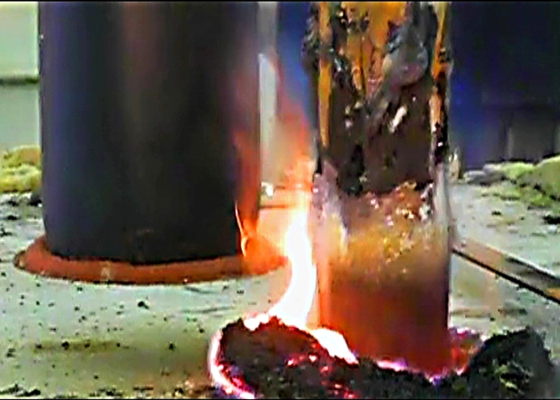

Still from IFC's free, downloadable video that demonstrates proper firestopping metods for electrical engineers and contractors

The video, which depicts a full-scale room fire at UL's Northbrook, Ill.-based test facility, visually compares non-compliant firestop systems performance to compliant firestop penetration and joint systems in accordance with ASTM E814 (UL-1479) and ASTM E1966 (UL-2079), respectively. While the test's compliant firestop systems weren't breached, the failing non-compliant systems allowed smoke and flame migration to adjacent spaces, of which smoke is the cause of three-fourths of fire-related deaths, according to NFPA statistics.
