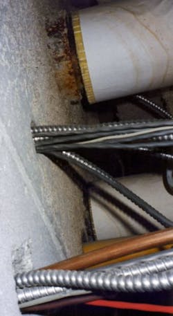

Photo 2. The unsealed cable penetrations in this drop ceiling space have negated the fire-resistance rating of this concrete block wall.
As a result, construction professionals have been getting away with not complying with firestop standards (Photo 2).
“They haven’t had to worry about the inspections,” says Miller, revealing that this is about to change.
