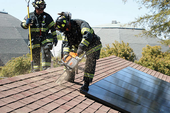

Firefighters typically use rooftop venting techniques when battling a blaze (Photo courtesy of Matthew Paiss, San Jose (CA) Fire Department).
