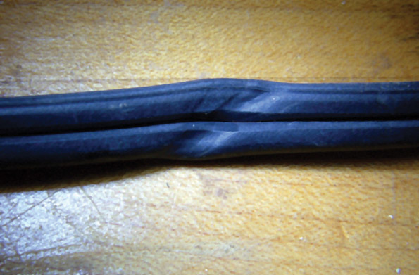

Note how this power cord has been pinched, which could easily lead to an unintended electrical path.

I then attempted to reassemble the package and found the process to be very awkward. The wiring had to be placed between slots in the case under the transformer before the transformer was nested into the housing on top of the wiring. Then, two long screws were driven through holes in the transformer, sandwiching the AC line cord between the transformer terminals and case. I could not fully tighten the screws without pinching the line cord. The transformer was again removed from the housing without further damaging the line cord.
The culprit
Even though this exemplar power pack had not failed, it exhibited evidence of a design defect. The power cord entered on one end, went through a tortuous path, and terminated on the transformer terminals, where it was squeezed against the plastic housing. The power cord was pinched, leaving indentations in the insulation. These indentations showed evidence of mechanical compression in several spots on the line cord.
During assembly, the line cord must have become pinched as the transformer was assembled into the enclosure (Photo). In this design, once the cord becomes pinched under the transformer, the problem is hidden from view.
Several other exemplar power supplies of the earlier design were examined, each one exhibiting similar evidence of mechanical insult to the line cord insulation at the same location. What if the cord should become twisted or folded over itself at the pinch point? The risk of an unintended electrical path would be even greater.
In my opinion, as well as that of the electrical engineer on the team, the wiring path and packaging design of this power supply was defective. It was also a prime candidate for the cause of this fire. In the later power supply design, the line cord takes a direct path to the transformer, and adequate space is provided for the wiring. The revised design is much easier to assemble, and there is no chance of pinching the wiring during assembly. In the revised design, the wiring can be inspected before final assembly of the enclosure. The design defect was corrected.
Having found the line cords pinched in all exemplars of that type, the electrical engineer and I had a theory of fire causation. A pinched line cord, inside a warm enclosure, powered continuously. Over time, the insulation continued to creep until an unintended conductive path developed.
What was the actual mechanism of insulation failure and establishment of just the right current level for just enough time to ignite plastic and rubber components on the treadmill? That was the subject of much discussion and dispute between the parties. Was there evidence of arcing? If not, why not? Was it arcing through char (i.e., charring of the insulation medium and the subsequent arcing between energized phase conductors and the neutral or ground or both)? Why did it take several years for the failure to occur? Where is the evidence to support this causation scenario?
We believed that under the right conditions, the entire power cord could become an ignition source. The electrical engineer and I felt confident that we had discovered the actual cause of the fire. However, we knew our theory would be challenged. The physical evidence of a conductive path was nowhere to be found, because the smoking gun had been destroyed in the fire or lost in evidence recovery.
To prove that an overheated line cord can ignite the treadmill, we performed a test. We first determined that a current of about 60A was sufficient to make the cord glow orange in about 20 sec to 30 sec, before tripping a 20A circuit breaker. (Breakers were found tripped at the fire scene.)
The manufacturer advised that its materials meet the applicable standard for flammability. To support our theory, we had to try igniting a treadmill. Placing the cord on a carpet below the treadmill, we successfully proved our ignition scenario was viable.
