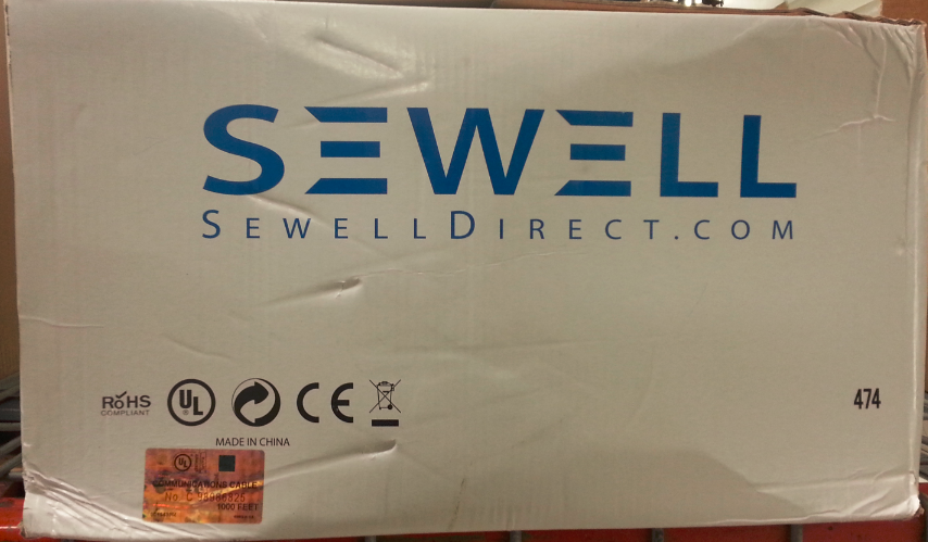

Identification on the Cable: The surface of the cable jacket displays the following description: SEWELL SFTP CAT5E EIA/TIA 568 CMR (UL)E353635 24AWG 4 PAIRS
Identification on the Box:
One side displays the following:
PURE RUN BY SEWELL
CMR SFTP (FOIL & BRAID) CAT5E CABLE
1000FT
CMR (UL) 353635
BASE1000-T
350MHz
MARKED EVERY FOOT
24AWG
UV PROTECTION
Another side of the box contains the following:
SEWELL SEWELLDIRECT.COM
