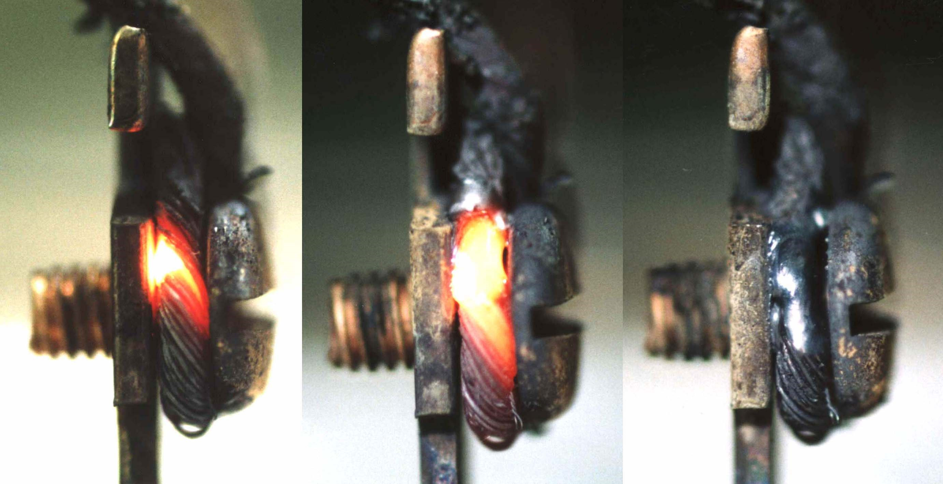

More common are failures of screw connections at duplex receptacles. Photo 2 shows a laboratory experiment exhibiting a progressive sequence of failure at such a connection. Poor connections often — but not necessarily — appear to be glowing, which can involve temperatures in excess of 2,192ºF (1,200ºC). Note that while copper itself melts at 1,981ºF (1,083ºC), its oxides can be heated to higher temperatures.
It’s important to appreciate that glowing may not be steady but may rather have an intermittent character. It is also important to understand that while reaching such high temperatures is of serious concern, not all glowing connections lead to a fire. Instead, a significant fraction will simply open up and no longer function. This is why finding “dead” outlets in a building should be a major concern to inspectors. The likely reason why an outlet died is that there was a bad connection that, after a certain amount of time, opened up. Left undisturbed, the connection is likely to stay dead. However, the concern is that the same individual who installed this receptacle wired other outlets in the same manner, and one of those could very well lead to fire rather than an open circuit.
