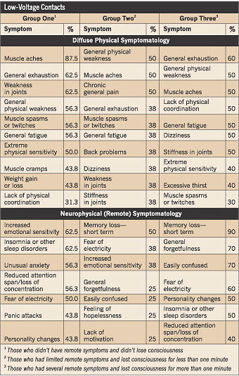

The results are a mixed bag. More than 87% of patients who were shocked by 110V but didn't lose consciousness still suffered from muscle aches three months after the event in the areas of the body where the current would have theoretically traveled (Table). Almost two-thirds experienced weakness in their joints, and more than half were generally fatigued. As for psychological problems, nearly two-thirds of that group had trouble sleeping and reported being more emotionally sensitive.
The severity and frequency of physical symptoms decrease for those who lost consciousness for less than a minute and experienced limited remote effects (those outside the theoretical current path), but half still suffered from general weakness, muscle aches, and chronic pain. Psychological problems also diminished some for this group, but half experienced memory loss.
Seemingly, the combination of symptoms becomes more complex as time spent unconscious increases and effects manifest farther from the current path. Those who lost consciousness for more than a minute and experienced pain at a maximum distance from the theoretical current path didn't endure a marked increase in physical symptoms, but the frequency of psychological problems increased dramatically. Nine out of 10 complained of short-term memory loss, and nearly three-quarters claimed they were more forgetful and easily confused. Morse and his colleagues speculate that although the percentage of respondents who manifested physical effects remote to the entry and exit points was lower, the high frequency of psychological symptoms suggests electric shock can have diffuse effects because in all cases the brain was outside the current path. “It occurs across just about any demographic line,” Morse says. “I want to know the answer to all the unanswered questions.”
