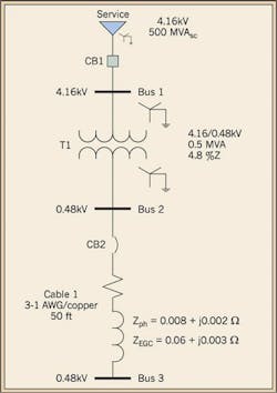

Fig. 1. Shown is a simplified single-line diagram.

In NEC-based installations, prospective touch voltages coincide with the voltage drops across the EGC connecting the faulty equipment to the main ground bus. To better clarify, consider the simplified single-line diagram of Fig. 1, where Bus 3 is ground faulted. Let us build the fault-loop equivalent circuit and calculate the voltage drop on the EGC connected to Bus 3, as well as the fault current flowing subsequent to the ground fault.
The electric utility short circuit contribution Ssc at the service entrance is 500MVAsc at the voltage V1= 4.16kV, with an XS/RS ratio of 10; the impedance (Zs) of the source can be calculated as follows:
Equation 1:
Equation 2:
Equation 3:
XS = 0.034 Ω
The transformer (T1) has a percent impedance (Z%= 4.8% on a 0.5MVA base), with an XT1/RT1 = 4.7, an apparent power rating ST1 = 0.5MVA, and a secondary voltage V2 = 0.48kV. Hence,
Equation 4:
Equation 5:
Equation 6:
Equation 7:
Cable 1 is 1 AWG and 50 ft long; the EGC, of same length, is 10 AWG. Both wires are in steel conduit.

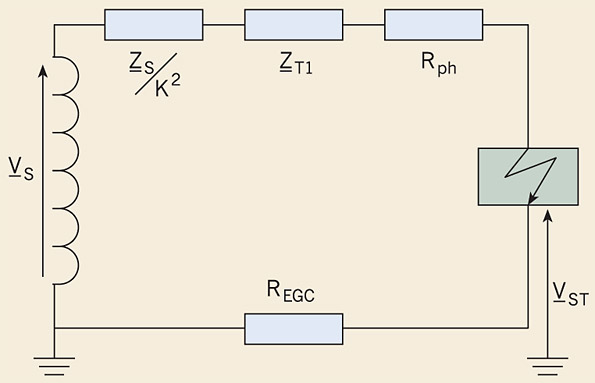

Fig. 2. Equivalent fault-loop circuit of Fig. 1 where Bus 3 is ground faulted.
The prospective touch voltage VST at Bus 3 can be calculated based on the fault-loop equivalent circuit shown in Fig. 2.
When circuit conductors have a wire size less than 2 AWG, their reactance may reasonably be neglected in calculations, being at most 18% of their resistance; thus, conductor resistances may be used instead of impedances. Thus:
Equation 8:
The underlined quantities represent complex numbers, where: Vs is the phase-to-ground voltage at the source; Zs is the internal impedance of the source; k= V1/V2 = 4,160V/480V = 8.666 is the winding turn-ratio of the transformer T1; REGC is the resistance of the equipment grounding conductor; Rph is the resistance of the cable phase conductor; ZLoop is the total fault-loop impedance, comprising the source referred to the secondary side of the transformer, the resistances of the transformer, cable phase conductor and equipment grounding conductor up to the point of fault.
If we plug into equation 8 the above numerical values in correspondence with their respective quantities, we will obtain:
Equation 9:
By applying Ohm’s law, we can also determine the fault-loop current:
Equation 10:
Thus, the touch voltage and the fault-loop current will respectively have the magnitudes of 224V and 3,471A.
