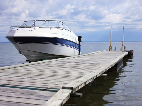

Even small amounts of current radiating from the metal hull of a boat with faulty wiring can be enough to cause a person’s body to seize and prevent them from swimming to safety (Bob Bremner/iStock/Thinkstock).
Of all the stories on Rifkin’s list, there’s one that hit him especially hard. “Like all of the others, it didn’t have to happen,” he says. “It shouldn’t have happened.” But it did, and he and a handful of others are working to make sure that something good can come of it.
Silent killer
At first, when the boys started screaming, their families thought they’d been stung by bees or bitten by snakes. It was 2:20 in the afternoon on July 4, 2012 — it seems so many of these incidents occur on a July 4 holiday, as summer boating season really gets underway — and 10-year-old Noah Dean Winstead and his 11-year-old friend, Nate Lynam, were swimming between two boats at the German Creek Marina in Grainger County, Tenn.
But as the adults caught sight of Noah Dean and Nate, struggling to keep their heads above water, it was obvious that their situation was much more dire. One after another, Nate’s grandparents, parents, and a family friend jumped in to help, only to have their bodies seize up as well. It wasn’t until another friend tripped a breaker on the boat that the adults’ muscles relaxed, and they were able to make their way out of the water. For the boys, though, it was too late. Noah Dean died there at the dock; Nate died the following day.
The culprit? Frayed wiring on one of the boats energized its hull, sending lethal levels of current into the water. But an investigation by the state’s Department of Commerce and Insurance found that the entire marina was rife with problems, including nearly two dozen instances of missing ground wires or the use of power meters not rated for a marine environment.
