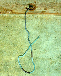

Through the years, the Code has been revised to better define the proper design of pool equipotential bonding and grounding systems, which must remain operational over the course of many years. Following and maintaining those guidelines is essential, Hamilton says, both in the installation of new pools and the ongoing servicing required of pools as they age. Most critical is the equipotential bonding grid, consisting of copper-wire connections to metal components in and around the pool, which equalizes voltage and lowers the risk of electric shock.
CMP 17 addressed bonding again in the 2014 Edition of the Code. Concerned that wording referencing the “bonding of pool water,” was confusing, the panel revised Sec. 680.26. It now states that “pool water must have an electrical connection” to specific bonded parts, or “the water must be in contact with a corrosion-resistant surface that’s at least 9-square inches.” A new requirement to ensure functionality is that the item making contact with the water must be “in an area where it won’t be dislodged or damaged… .”

In his years as an electrical and building code enforcement officer for the town of Ithaca, N.Y., Chas Bruner has witnessed a less-than-ideal grasp of the bonding concept, in particular. That’s compounded by installers who sometimes choose not to hire electrical specialists to do the work, a byproduct of comparatively loose state regulations on employing licensed electricians.
“Some people aren’t trained, and, in a lot of cases, you have college kids doing the installations,” he says. “So you end up counting on seeing some pretty flimsy bonds and since there can be a lot of different pool designs, it can be hard to see if they’ve selected the right way of doing it.”
Install jobs can be difficult to thoroughly inspect as well, he says, because the perimeter bonding is quickly covered with concrete in fast-paced jobs. “You have to get there quickly,” he says. “I’ve had concrete trucks ready to pour, waiting for me to give the OK. In some cases, I’ve had to hold them up.”

Even if they’re installed properly — and that’s hardly guaranteed if work is governed by outdated versions of the NEC — pool bonding and grounding systems are subject to wear and tear. Over time, these systems can and do corrode, and a host of variables can affect the pace of decline. That fact heightens the importance of, as the pool group APSP advises, “inspection, detection and correction” to address things like “aging electrical wiring, the use of sump pumps and vacuums that are not grounded and lack of proper bonding.”
Triec Electrical Services, Springfield, Ohio, has heeded that call. Motivated partly by news of pool electrocutions, Owner Scott Yeazell says he’s recently begun offering complimentary inspection and testing of pool bonding. He suspects there are enough degraded systems in existence that repair work will provide the payback. He’s eager to step in because he knows vigilance can be the difference between life and death.
“Bonding is your secure backup. If it’s gone and you don’t know it, you’re at risk,” he says. “But I don’t see any program or commonly accepted practice of testing bonding to see if it’s intact or not.”
