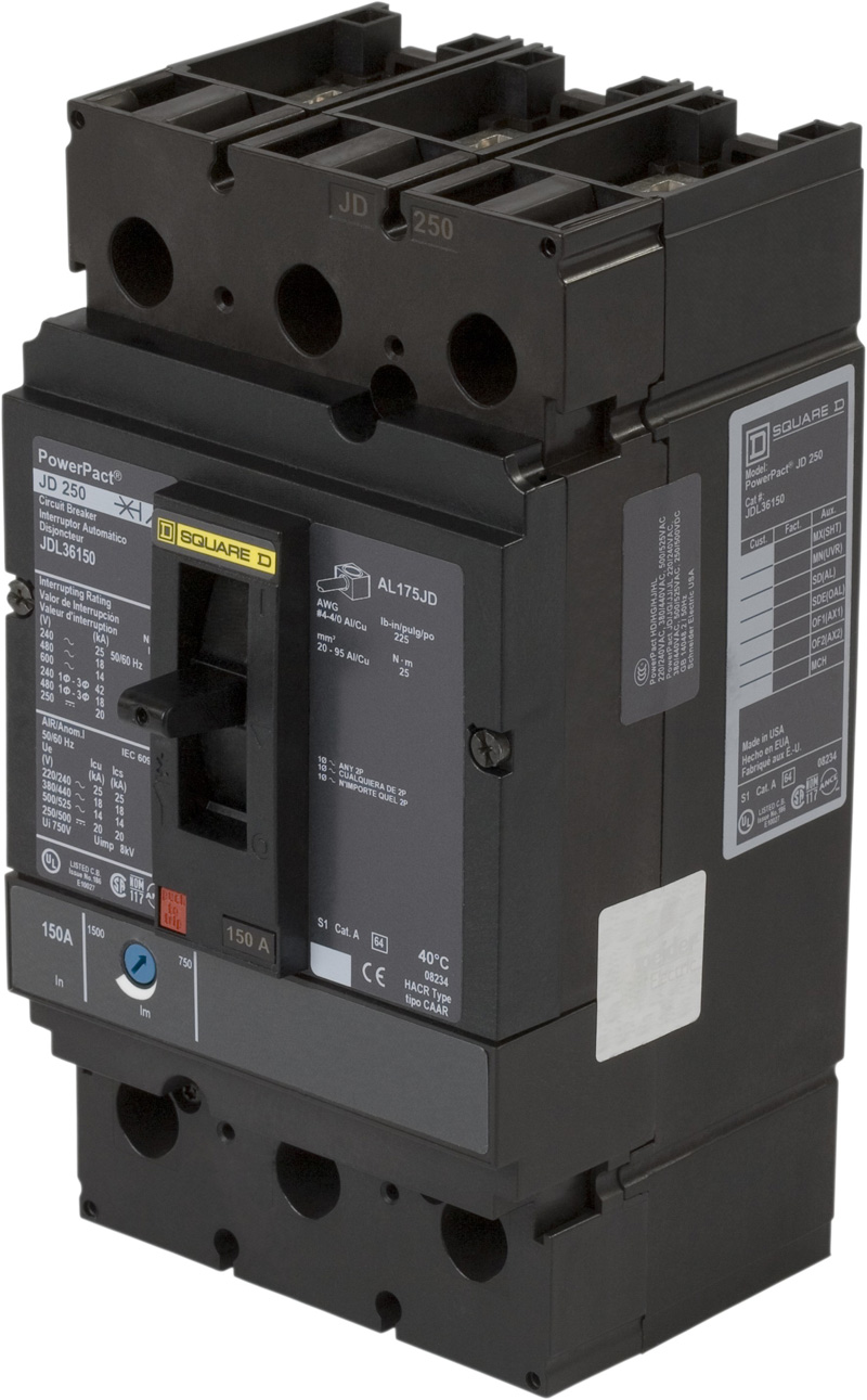

Schneider Electric is recalling about  62,500 PowerPact J-frame molded case circuit breakers with thermal-magnetic trip units. The circuit breaker will not trip during an overload condition, posing a risk of fire, burns and electrical shock.

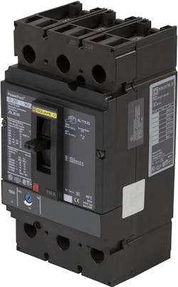

The circuit breakers are made of black plastic and have a three-position breaker handle that indicates whether the breaker is off, on or tripped. The recalled circuit breakers are rated for 150A to 250A, have interruption ratings of D, G, J, L and R. They were manufactured in two pole and three pole configurations with either lug-in/lug-out or plug-in (I-Line) style connectors.
Brand name “Schneider Electric” or “Square D” is on a yellow sticker above the breaker handle and on the top of a label on the side of the circuit breaker. A label on the front of the circuit breaker to the left of the breaker handle has the catalog number at the top.  The number also appears on a label on the side of the breaker. Schneider Electric catalog numbers begin with “NJ” and Square D catalog numbers begin with “J.”
A label on the front of the circuit breaker to the right of the breaker handle has the date code in the lower right corner. Recalled circuit breakers were manufactured from March 24, 2014 through September 26, 2014 and have date codes 14131 through 14395. The date codes are in the YYWWD format (example: 14131 = year 2014, week 13, day of the work week 1/ Monday).
Consumers should immediately stop using the recalled circuit breakers and contact Schneider Electric for either a free replacement circuit breaker and a credit of up to $300 per address to cover labor costs for installation by a certified electrician or a handle update kit and a credit of up to $150 per address to cover labor costs for installation by a certified electrician.
