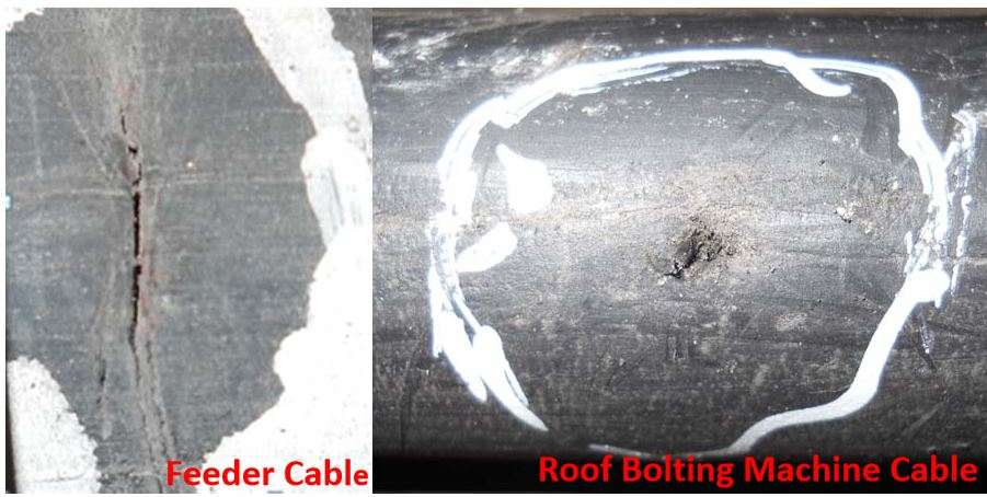

The second miner was shocked while hanging a feeder cable during a belt and power move. The cable, mine floor, and the miner’s gloves were wet. The feeder cable’s outer jacket and insulation were damaged.
The third miner was shocked while handling a roof bolting machine cable. The cable, mine floor, and the miner’s gloves were damp. The cable had a small hole in the outer jacket and a damaged conductor.

  • Always handle de-energized cable instead of energized cable, or wear properly rated and well-maintained electrical gloves when handling energized cables.
  • Conduct complete and thorough examinations on all electrical equipment. This includes hand-over-hand examinations of de-energized electrical cables.
  • Protect electrical cables from damage by mobile equipment and falling roof materials. When cable damage is suspected, immediately notify a qualified electrician so a potentially dangerous condition can be corrected.
