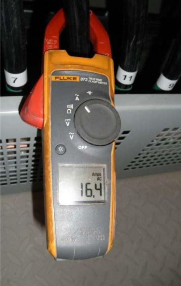

Objectionable Current Reading Taken February 14, 2016 – New Office Annex (NOX) Basement Switchgear Room. (OIG photo
Specifically, OIG and the USACE team, which included master electricians from Task Force Protect Our Warfighters and Electrical Resources, discovered objectionable currents measuring up to 16.7A in the New Office Annex building (NOX) and up to 27A in the residential apartment building (SDA-1). Objectionable current is defined as electrical current occurring on the ground wiring of a building. Although the National Electrical Code (NEC) does not establish a life safety threshold for objectionable current, Task Force POWER considers any objectionable current a risk to life and safety.

Based on its inspection, Task Force POWER’s initial observation is that improperly installed wiring is the likely cause of the objectionable current in both buildings and found evidence of an improper neutral and ground bond in at least one panel. Given the levels of objectionable current identified in both buildings. Task Force POWER believes that other improper connections — which electricians refer to as neutral-to-ground or neutral-to-case bonds — exist but have yet to be located.
