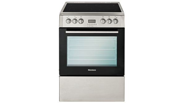

The U.S. Consumer Product Safety Commission (CPSC), Arçelik A.S. of Turkey, and Beko US, of Bolingbrook, Ill., are voluntarily recalling about 6,300 Blomberg and Summit brand freestanding electric ranges. The electric ranges can become energized because a screw was not installed to secure the grounding strap during manufacturing, posing electric shock and electrocution hazards.
In August 2016, a 52-year-old professional plumber from Portsmouth, N.H., was electrocuted when he came in contact with an energized range and a grounded object.
This recall involves Blomberg BERU 24200 SS, BERU 24100 SS, and Summit CLRE24 24-in.-wide freestanding glass top electric ranges. The ranges were sold in stainless steel and black. A label on the lower frame of the range inside the over door has the brand name “Blomberg” or “Summit,” the model name and number BERU 24200 SS, BERU 24100 SS, or CLRE24 and a 10-digit serial number. Serial numbers included in the recall are:
