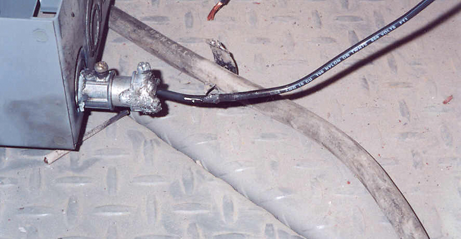

    In the case of the fatality from stray welding current mentioned previously, the welder had connected his workpiece lead to a foundation structure bolt more than 100 lineal feet from his weld location. The result was that his welding current flowed through an electrical circuit ground system, destroying conduit fittings (Photos 2 and 3).

    In the incident where the young victim died, the welding current had melted the cast metal connectors of the electrical metallic tubing (EMT) for the temporary construction power supply. In this case, it was the circuit supplying the welding machine. Heating of the metal fittings caused the phase conductor insulation to melt, connecting the remaining ground circuit with the phase conductor.
