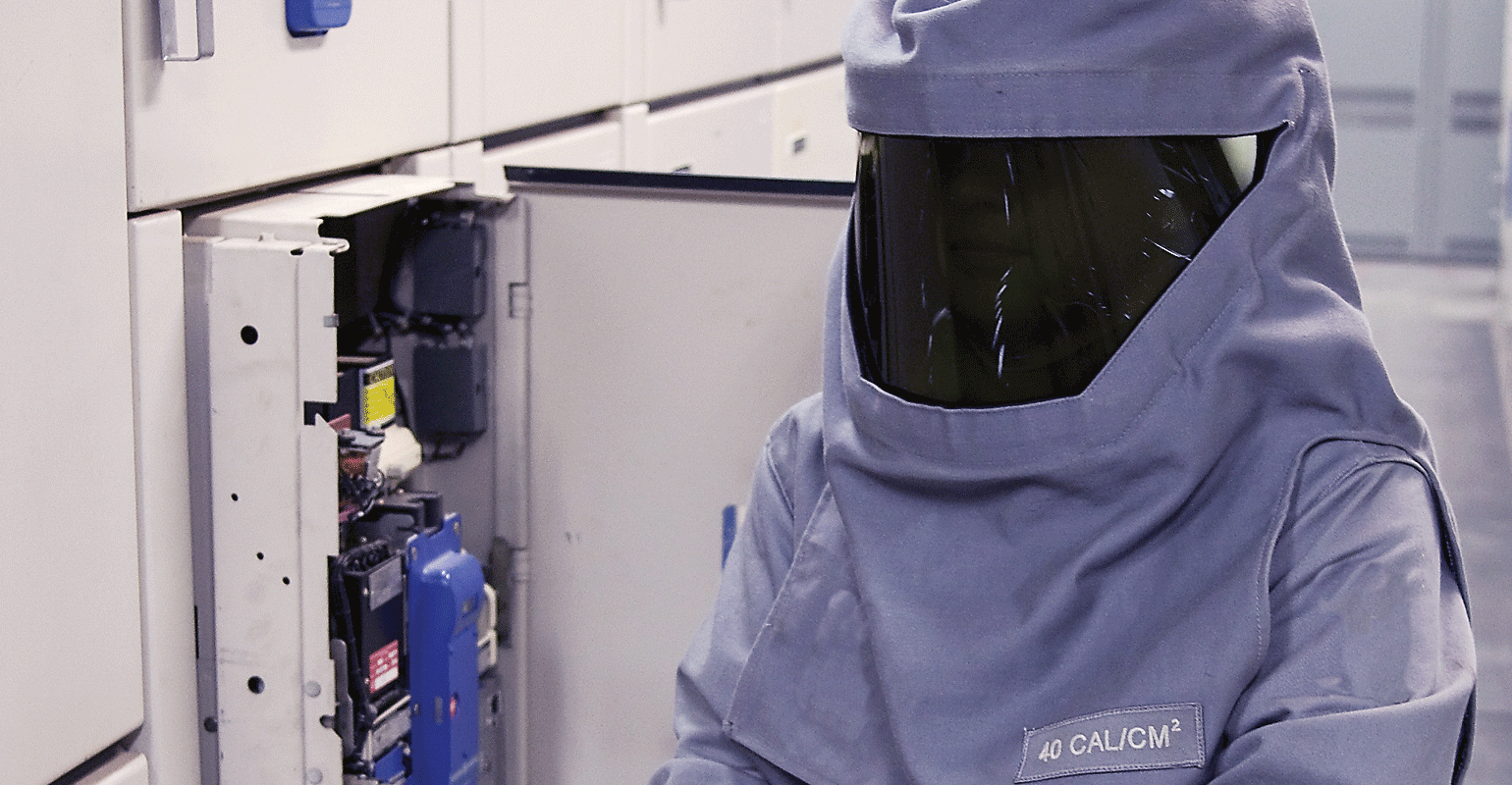

Creating a safer electrical work environment also calls for building greater awareness of arc flash/arc blast hazards. A danger that has become better understood and more manageable over time, arcing leads to far fewer deaths than electrocution, but poses a serious threat to workers. In fact, it may injure more workers than shock. Step one in avoiding it during equipment maintenance and repair is assessing the risk of its occurrence and relative danger. The best way to do that is to conduct detailed arc flash studies, experts say.
Josh Mikels, P.E., the lead arc flash specialist at Brady, says an analysis of each piece of electrical equipment can produce readings on the amount of incident energy that could be encountered by workers. While calculations are available through a speedier “table method” of calculation in NFPA 70E, a formal study provides more certainty and can reveal better mitigation tactics and safe boundaries for workers.
“When you do an assessment, you’re telling someone whether you’re potentially dealing with a firecracker or a nuclear weapon,” he says.
That’s important to know, because it informs how work is performed on equipment and the type of PPE that must be worn to withstand an arc flash or blast should one occur. Too many companies, Mikels says, risk sending workers into potential arcing situations with PPE that doesn’t protect, raising the risk of severe injury. “If you’re doing that work with the wrong PPE, you’re in danger. It’s like trying to cross an eight-lane expressway in LA.”
That appropriate-PPE gap probably aligns with the number of companies that have yet to conduct or outsource comprehensive arc flash studies.
“More companies have probably developed lockout/tagout procedures than have done arc flash studies,” says Mikels. “My guess is less than half of all facilities have one in place.”
