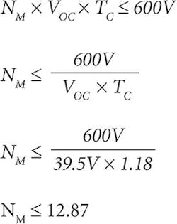

    The quantity of modules that can be connected in a series string is limited by the system operating voltage, typically 600V. Large commercial or utility systems could be higher at 1,000V. According to Sec. 690.7 of the NEC, the maximum PV source circuit voltage shall be calculated as the sum of the rated open-circuit voltage of the series connected modules corrected for the lowest expected ambient temperature. The open-circuit voltage (VOC) is the maximum voltage generated by a PV module and can be obtained from the PV module data sheet. If a data sheet is not available — or there are multiple modules being considered — then the NEC provides a generic table of correction factors for crystalline silicon modules (Table 1).
    Example 1: Given the NEC information in Table 1 and the PV module data in Table 2, calculate the maximum quantity of modules you can connect in series. Assume the system voltage is 600V, and the location is Detroit, Mich.
    The first step is to go to Solar ABCs and find the lowest ambient temperature in order to determine the proper correction factor. The extreme minimum is -19°C. Based on NEC Table 690.7, the correction factor would be 1.18. The maximum number of modules (NM) connected in series is given below.
    The maximum quantity of modules connected in series without exceeding the 600V based on the location is 12 modules. If string sizing doesn’t seem like fun to you, then there are online string sizing programs to help.
