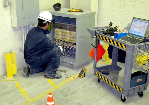

“You need equipment to run under normal operating conditions for thermal imaging to be meaningful,” reiterates Marc Wild, a certified IR thermographer with ThermoTest, a Fishkill, N.Y., provider of IR thermography services. “With infrared you can pick up a fault very easily, for example, an overloaded circuit, imbalanced load, or loose connection. However, you need to have an understanding of how the equipment is supposed to function to interpret if it is a problem or not.”
Capturing images of energized equipment requires the IR technician to adhere to strict arc flash safety guidelines (Photo courtesy of ThermoTest).
