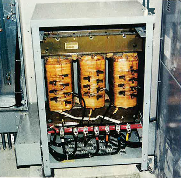

Let’s look at a very common area of error: nominal voltage. Commercial and industrial facilities typically use some combination of 480/277V and 208/120V. Often, the electric utility provides 480V at the service. A center tap on that service transformer provides 277V.
For offices and general receptacles, you need 120V, so stepdown transformers supply 208/120V. Sometimes, this is just one big transformer and one big panel. While that arrangement saves the design engineer time, it typically increases the cost of construction and definitely increases the cost of operation.
Ideally, you will distribute 480V as far inside the building as you can — so far that all feeders are 480V and only branch circuits are at a lower voltage. First of all, it costs less in labor and materials to carry that same power at 480V than at 120V (smaller wire due to lower current, smaller raceway due to smaller wire, etc.). More important, the distribution itself is more efficient at 480V. The closer the 120V transformer is to its 120V loads, the more energy-efficient your system will be. Thus, it’s smart to:
  1. Use several small, strategically situated 480V-120/208V transformers instead of one large, centrally situated one. The idea here is to get the shortest 208/120V branch circuits that are practical.
  2. Use a similar approach for 277V. Rather than a center tap off the service transformer, use several smaller 480V-480/277V transformers. Better yet, see if you can replace 277V with 480V, since the typical uses (lighting and reheat boxes) are available in 480V versions.
Yes, there’s additional engineering cost involved with this route, but the construction savings alone may pay for it. Consider that you’ll run smaller conductors in smaller raceways. You’ll recover costs in other areas, also. The real payoff, however, is in the energy savings. These savings will continue over the life of this infrastructure.
However, the savings can be vaporized by errors in construction. To prevent that, perform AC resistance testing across feeder connections prior to energizing the system. Then ensure that all connections are subject to periodic thermographic inspection so that high resistance connections can be disassembled and replaced with new hardware. Remember, simply tightening a “loose” connection (one indicated as hot by the thermographic inspection) can actually make matters worse. If it’s a bad connection, replace it with a good one.
