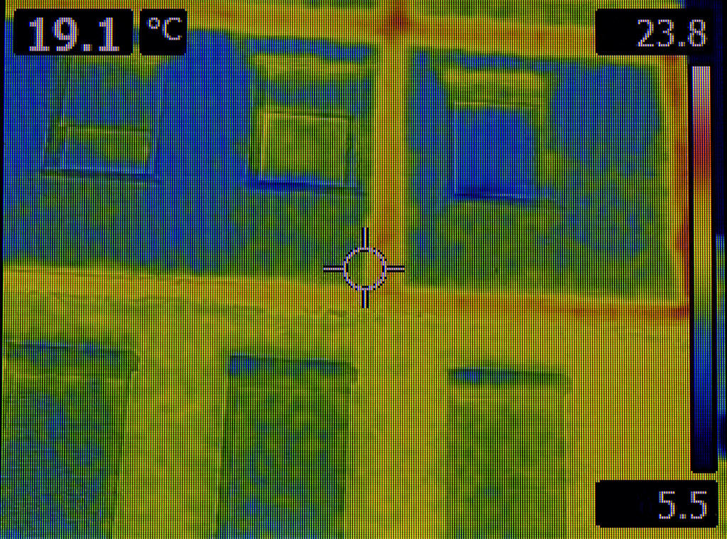

Conduct a thermographic analysis on the building itself--not just on the building envelope, but also on entities within the building. Look at anything that has power run to it.
The goal here is to determine where heat is generated, leaked, and pooling. To the best of your ability, also determine how it flows through (and out of) the building. Once you’ve put this together, you will be able to see where it makes sense to install fans to redistribute, redirect, or exhaust heat.

You create a heat flow map, using data from thermograhic scans. You find that heat in “the shed” tends to either pool in certain areas or flow to the thermal weak spots of the building envelope.
In the winter, heat that should help make the place more comfortable is simply wasted. The summer floor fans don’t effectively solve the heat problem, for several reasons, including the fact that random placement causes them to fight each other. The building needs a means of managing the heat and air flow, so that winter waste heat no longer is wasted and summer waste heat is properly exhausted.
