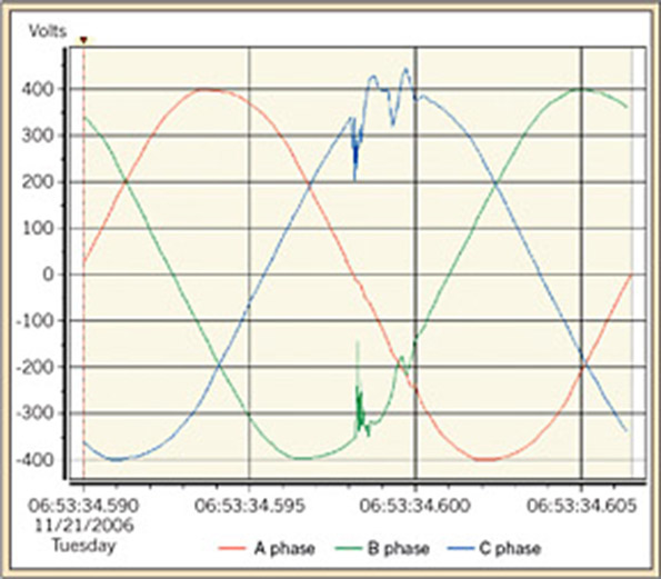

All kinds of quick fixes exist for protecting motors from transients. But they address only one range of voltage [e.g., metal oxide varistors (MOVs) on the power supply], or they don’t actually do anything at all (e.g., ground rods connected to the motor), or they are in the wrong location (surge protectors only at the service) to provide real protection.
Most transients capable of damaging a motor are generated within the facility. So first address those sources. Those sources are typically other large motors that start across the line. Installing soft starters or variable frequency drives (VFDs) on all large motors will eliminate those motors as sources of damaging transients.
Although this is a costly proposition, it typically costs far less than the damage from transients. Soft starters and VFDs also extend the lives of motors, thus reducing expensive motor failures. To get corporate approval for soft starters or VFDs, you may need to use a power analyzer to capture the power events so you have actual data showing where the transients come from.
