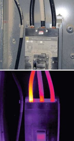

Photo 1. An untrained thermographer is unlikely to obtain this image, even with the best of cameras (Photo courtesy of Greg Stockton, United Infrared, Inc.).

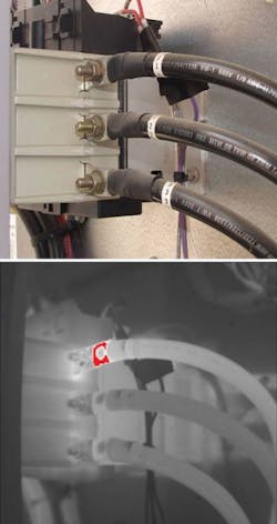

Photo 2. An untrained thermographer is unlikely to discover the problem with this breaker (Photo courtesy of Greg Stockton, United Infrared, Inc.).
With the investment of time and money, it might seem training and certification aren’t necessary for the typical user. That perception typically gets shattered on the first day of class. And once trainees are back on the job, “this was a really good idea” becomes readily apparent (Photo 1 and Photo 2).
