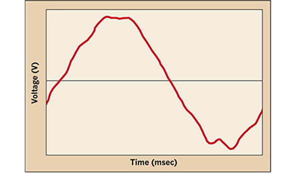

Maybe someone used a harmonic analyzer and found that your total harmonic distortion (THD) falls within the range of what one standard or another shows is acceptable. What that standard isn’t going to tell you is that 300 pieces of equipment running on that “acceptable” power are all wasting energy. And it adds up.
To reduce the waste, look for the load (or a few loads) that most contribute to harmonic distortion on a particular feeder — the big switching power supply in that control cabinet, for example. Many harmonics mitigation techniques exist, so figure out the one best suited to the specific application. It might be as simple as installing a tank circuit or harmonics filter.
