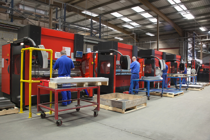

What if your production area undergoes fairly frequent reconfigurations? After each one come the inevitable complaints about the lighting, followed by an abundance of task lights plugged in all over the place.
The task lighting does solve the immediate problem for the production workers whose overhead lighting proved inadequate after the equipment moves. But what happened to the formerly adequate light? It’s now being wasted by being in the wrong place, and the “solution” wastes energy by adding energy-consuming task lighting to make up for the lighting misallocation.
