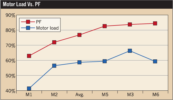

Under-loaded motors can operate below nameplate power factor (PF) rating.
In the vector math explanation of this, PF is the cosine of the angle between working power and apparent power. So at low load, there’s little actual electrical power (watts) required to rotate the motor. Thus, power factor is low because the resistive component is small relative to the inductance. During the compressor’s loading phase, the motor draws much more current and its resistive component increases relative to the inductance so PF goes up.
