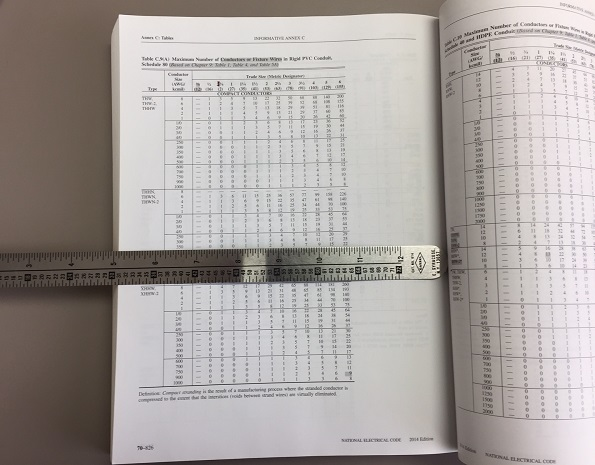

Take precautions, such as using a straight edge, to make sure you are correctly reading the tables in the NEC.
Have you ever made a boneheaded mistake that left you embarrassed? Maybe coworkers got a real hoot out of it and teased you for days afterward. Such mistakes may have the upside of providing entertainment, but they also may create serious problems.
Anyone who’s worked in this business for very long knows that applying the rules of the National Electrical Code (NEC) is one place where silly stupid mistakes occur. One reason is that the NEC is full of tables. Some of these, although well laid-out, may be visually confusing just because of their size. The large ampacity tables are a prime example. You could easily let your eye glide across the wrong line.
What’s the solution? Use a straight edge whenever working with such a table.
With smaller tables, you can leave the straight edge in the drawer. Right? It may seem so, but think about how you are physically using reference material such as the NEC.
Maybe the center space of your work area has your drawings or project specs or whatever main document you’re working on. You have your NEC off to one side, so you often read it at an angle. This can easily lead to a “visual misalignment,” and you end up reading the wrong line.
For example, look at Table 220.12. This is a clean, straightforward table. How can you possibly misread it? Angle the page and then look up the Volt-Amperes per Square Foot for Office Buildings. Odds are that you correctly read the value “2,” but the odds are not 100 percent. Given enough times using this table, you will at some point read above or below the correct line in the table. Unless, of course, you use a straight edge.
