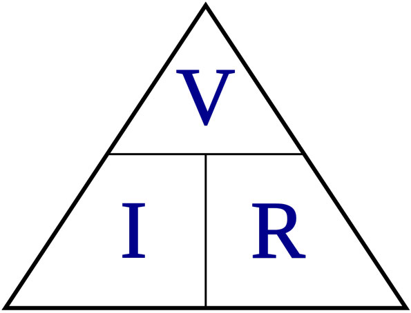

Not if you apply Ohm’s Law. If you bond all the metallic objects to the equipment grounding (bonding) conductor (EGC), you put them at the same potential. That means there are zero volts between them. Because current is voltage divided by resistance, current also is zero. No current flows between metallic objects that are at zero potential with each other.
Driving ground rods won’t solve the problem because it doesn’t put metallic objects at equipotential. How do we know this? Again, we apply Ohm’s Law. A bonding jumper has such low resistance that you can consider it to be zero; voltage is current times resistance so it ends up being zero. But soil has much higher resistance, and that resistance varies. Driving ground rods does not produce equipotential due to the resistance that’s still there.
Many “solutions” to problems resulting from bonding deficiencies are expensive yet ineffective. But a length of wire and two connectors costs very little and will “amazingly” bring undesired current flow to zero.
This is just one example of applying one item from basic electrical theory. How much of that basic theory have you forgotten? If someone asked you the formula for calculating voltage if resistance and current are known, do you have to look it up? It’s not a bad idea to take the time to periodically review basic theory.
