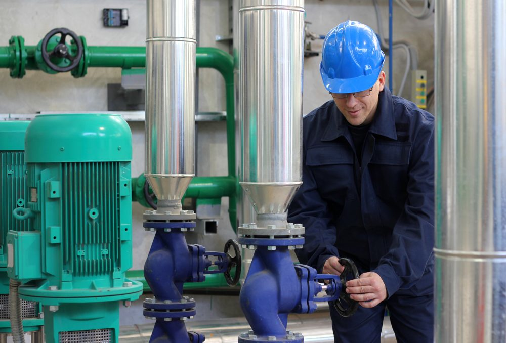

Pumps are ubiquitous in process plants and other industrial facilities. These are typically powered by Design B motors. The starting torque of Design B motors is considered “medium.”
Something that sometimes happens in plants is an operator tries to start a pump that is “dead headed.” The downstream valve is closed so the pump is (typically) trying to compress a liquid rather than push it through the piping. Because the Design B motor lacks the torque to start under such a load, it will generate considerable heat trying. Then it will blow its overloads. You’ll need to wait a while, maybe a couple of hours, before a restart attempt.
Before starting a Design B motor, ensure it’s not under load. If it runs a pump, ensure the pump isn’t valved out. This doesn’t mean you simply open a closed valve; verify with operations that valve operation is permitted and that flow through the system by operating the pump is also permitted.
