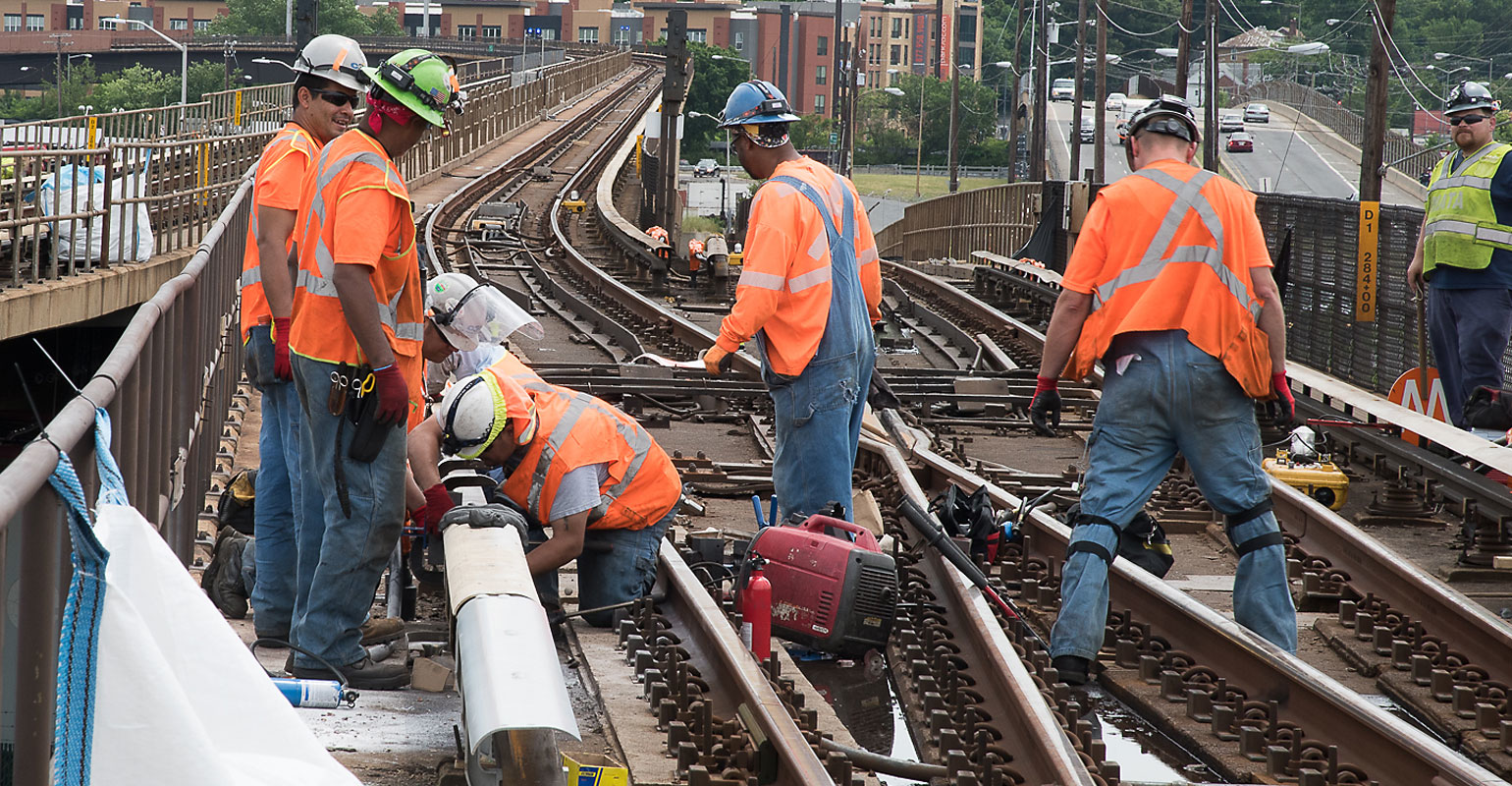

    Ahead of the new preventive maintenance program, and concurrent with a year-long push to pour resources into a concentrated and multi-faceted track improvement program called SafeTrack, WMATA in 2016 began targeting segments of the line where arcing was known to have occurred.
    According to an FTA report issued in December 2016 detailing its investigation of the TPE system, WMATA logged 70 arcing incidents in the year that elapsed after October 2015. And in the period between March 2016 and the drafting of the report, WMATA documented 58 arcing events that required emergency response because of smoke and/or fire.
    Deploying maintenance crews to areas of documented arcing, WMATA replaced insulators, secured power cables, eliminated third-rail joints, and addressed standing water — all conditions that, among others, can contribute to arcing. That appeared to produce results; a trouble-prone section that had four “major” and 14 less-serious arcing incidents over three months pre-maintenance, experienced eight minor incidents over the ensuing six months.

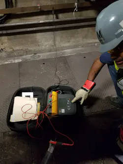

    Since insulation resistance and stray current testing require complete de-energization, and can’t be done in a way that cuts power to only one track in the two-track system, work will have to be compressed into off-peak hours. Late-night service will be cut back to open a bigger window for the work, but crews will still be under pressure to move methodically but determinedly through the process of cutting power, setting up and performing tests, collecting data, and restoring service. Plans call for all sections of the line — cables feeding the third rail that powers the trains and the negative, return side that carries electricity on a circuit back to substations — to be analyzed.
    “There are a lot of places where we don’t have a visual on the cables, so pursuing a visual inspection plan won’t give us a full picture,” Off says.
    The testing itself can be done rather quickly, Off says, but setup and repeating the process for each section is time-consuming.
    “The technique itself hasn’t changed much in 40 years, and there’s not much to it in terms of equipment,” he says. “The act of using the instrumentation represents a fractional minority of the total time needed to carry out the activity, which involves scheduling the work, disconnecting the rails, making sure it’s performed safely, collecting results, and producing a report on what actions we need to take.”
