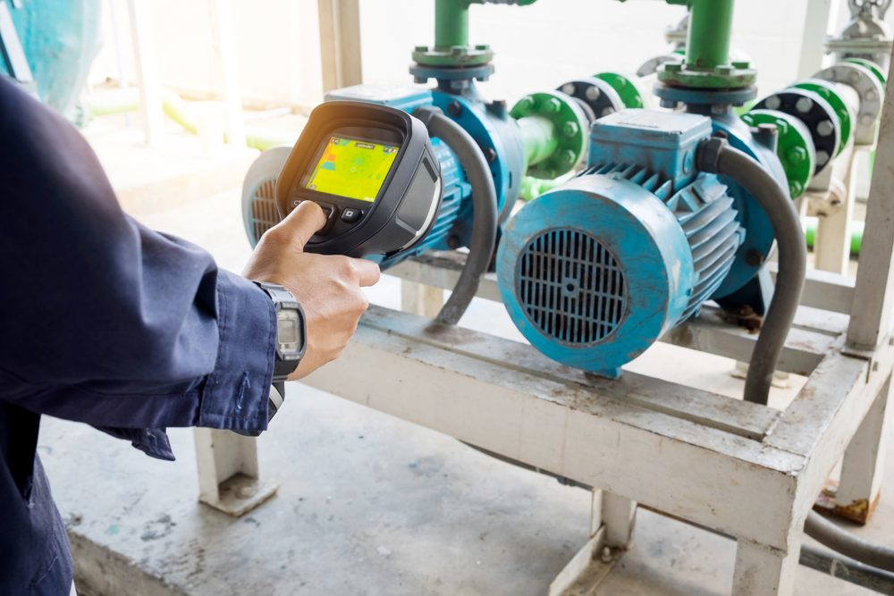

Here are some of the conditions to monitor and measure to help boost motor system reliability.
When added to the measuring done during scheduled preventive maintenance (PM) activities, monitoring can significantly boost motor system reliability. But what should you monitor?
The single biggest enemy of motors is, you guessed it, heat. Typically, a critical motor will be ordered with a temperature sensor in the windings. This can help prevent catastrophic motor damage if you can connect the sensor to a system that can send notifications to specific people for action when a high-level threshold is crossed.
But what about bearing temperatures? Monitor bearings also, adding sensors for that purpose; consult with a motor shop before finalizing your plans.
Poor ventilation can result in excess motor temperature, and so can excessively rapid restarting. But if you’ve taken care of these issues, voltage imbalance can defeat your efforts. Put something in place to prevent excess restarts.
