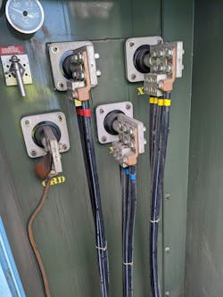

The 2023 ANSI/NETA MTS revision includes a major rewrite of the medium- and high-voltage cable testing section. Some sub-sections, like the rest of the revisions in the standard, were minor changes that might not be noticed without a thorough comparison of the standards. Those minor edits included:
- Adding connectors of cables as part of the general cable inspection.
- Looking for all forms of degradation (Photo 1).
- Checking supports and cable trays.
- Verifying cable routing through window current transformers, minimum bending radii clarifications, and optionally checking cable data to drawings and specifications.

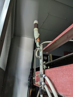

Several new and possibly different methods of testing that would impact testing organizations were adopted, such as testing all phase conductors together during insulation resistance testing (Photo 2) and optionally performing jacket integrity testing.

The consensus was that the acceptable insulation resistance values of shielded medium- and high-voltage power cables are not easily put into a table due to differences in conductor and insulation geometry, temperature, and, most importantly, length. The correct method of verifying insulation resistance is a trigonometric formula with dielectric constants that are not easily attainable. Therefore, although the insulation resistance test is a great pre-test to determine suitability for further testing, it should not be utilized to find a discrete number for acceptability in cable testing. These changes in evaluation provided a much-needed complement to the changes in the electrical test section.
