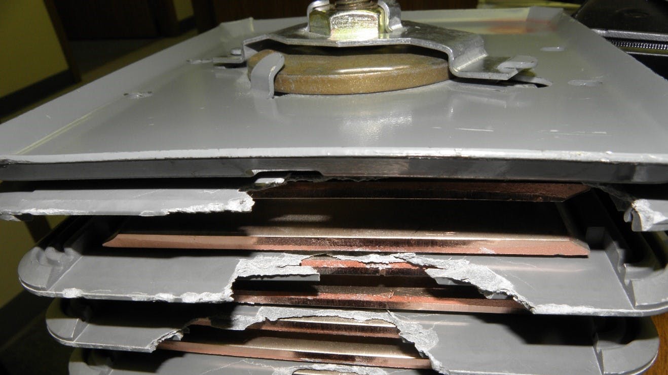

As part of equipment start-up, evaluating the busway insulation reading may indicate there is an improper neutral-to-ground connection present in an installation. The first step to locating this is to isolate the busway from the switchboard and other components/ equipment. Once a short is discovered, the most common procedure employed to find the fault is to remove a joint pack near a mid-run point and perform insulation resistance testing in both directions. Continue to remove joint packs at other halfway points on the remaining busway sections, and you’ll eventually locate the problem.
As indicated, this is the most widespread test practice, but it can be costly and dangerous. Trying to remove a joint pack 30 feet above the floor is possible but typically results in irreparable damage to the joint packs (Photo 1). And if it’s hard to remove, it will be even harder to replace. I have seen this procedure create new shorts during the removal/replacement process. The fewer you must remove, the better.
