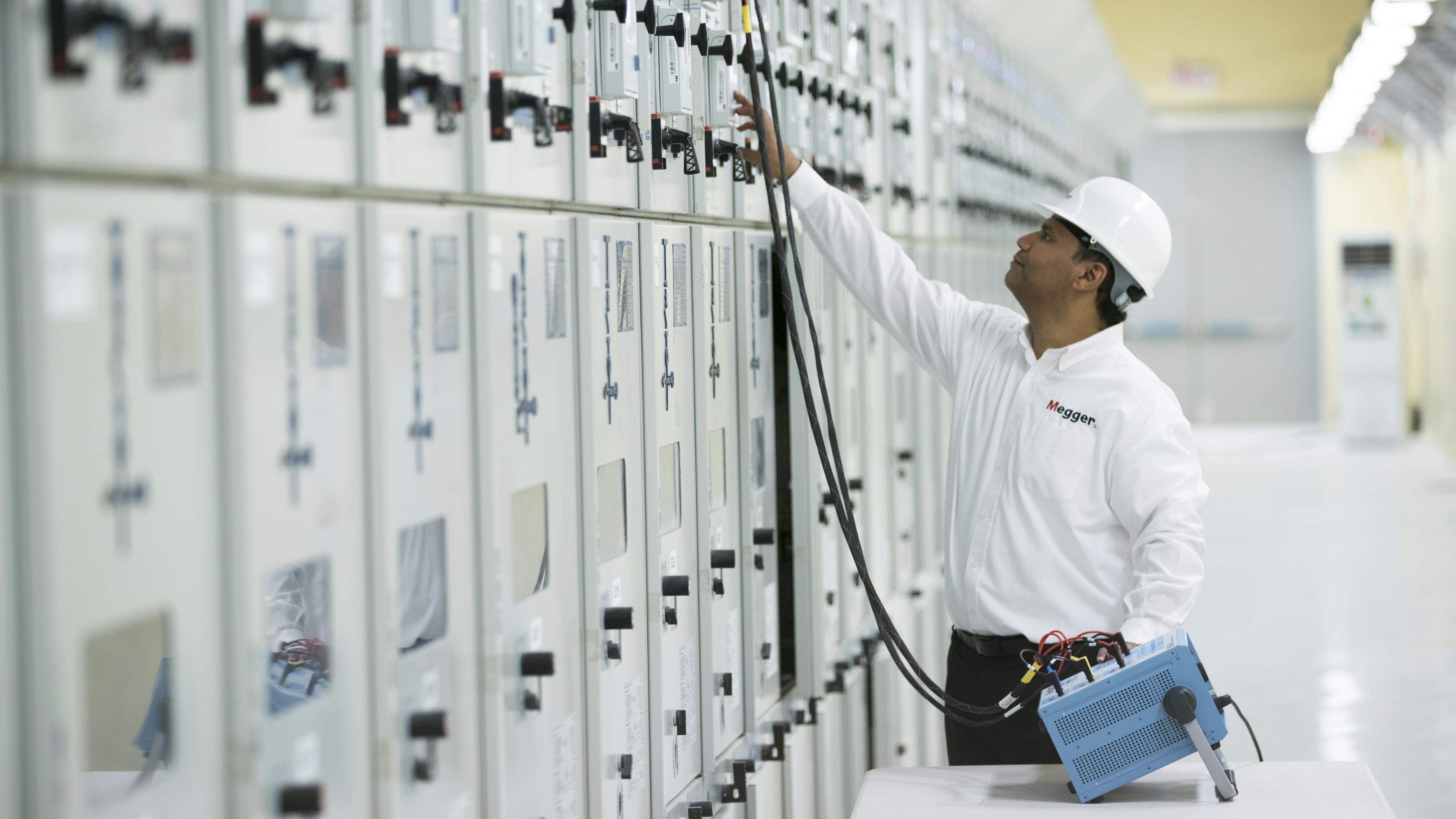

Testing plays a critical role in verifying that the protection scheme is designed to meet its intended purpose. It ensures the field wiring matches the schematics, and everything works seamlessly.
Why do we test?
While engineers and electricians are highly skilled professionals, they are human and can make mistakes. That’s why, during the commissioning process, we meticulously search for errors, knowing full well that they can exist anywhere.
It is imperative to verify cable sizes, color codes, and termination labeling in even the most carefully planned designs to ensure accuracy. Moreover, the creation of precise as-built drawings is crucial for future projects. Without proper maintenance, it becomes increasingly difficult to plan and design upgrades (Photo 1).

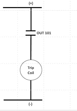

To illustrate, consider the DC schematic of a breaker trip circuit shown in Fig. 1. The normally open OUT101 contact breaks the positive leg of the 125VDC circuit of a specific component. The circuit breaker’s trip coil is energized by pulsing the OUT101 contact, proving that the signal is passed to a downstream terminal point or device when the contact is closed.
Pulsing the relay contact also verifies the relay contact’s ability to operate from an open to closed position and back again. Note that for simplicity, we have removed the auxiliary contacts that are usually present to provide supervision.
